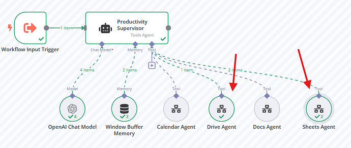

The second level agent then triggers multiple (third level) agents as tools to achieve the task
In my use case, this requires calling a Google Sheets Agent / Tool Twice and a Google Drive agent once.
Sequence in the example below is Google Sheets Agent > google Drive Agent > google Sheets Agent

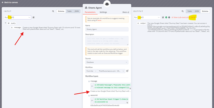

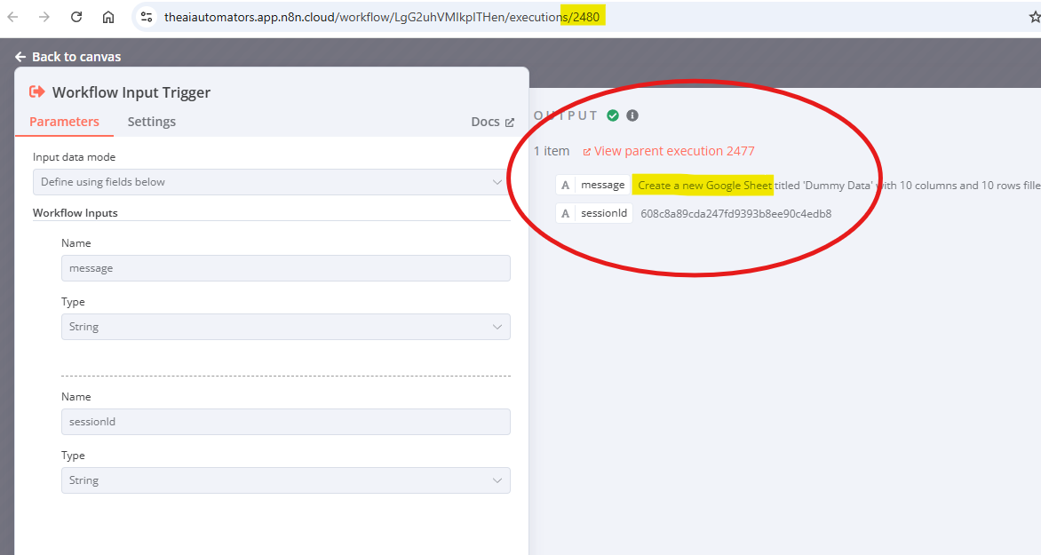

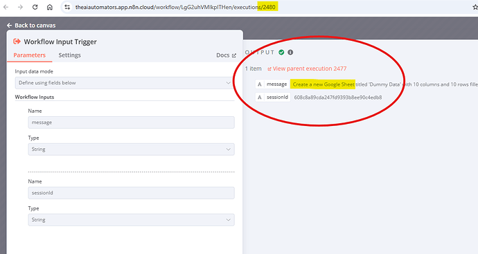

The issue lies in the second call to the Google Sheets agent tool. The AI Agent creates a new workflow input parameter to be sent to this tool / workflow
However it is not being passed - Instead the data from the first call is being passed again. Screenshots below …

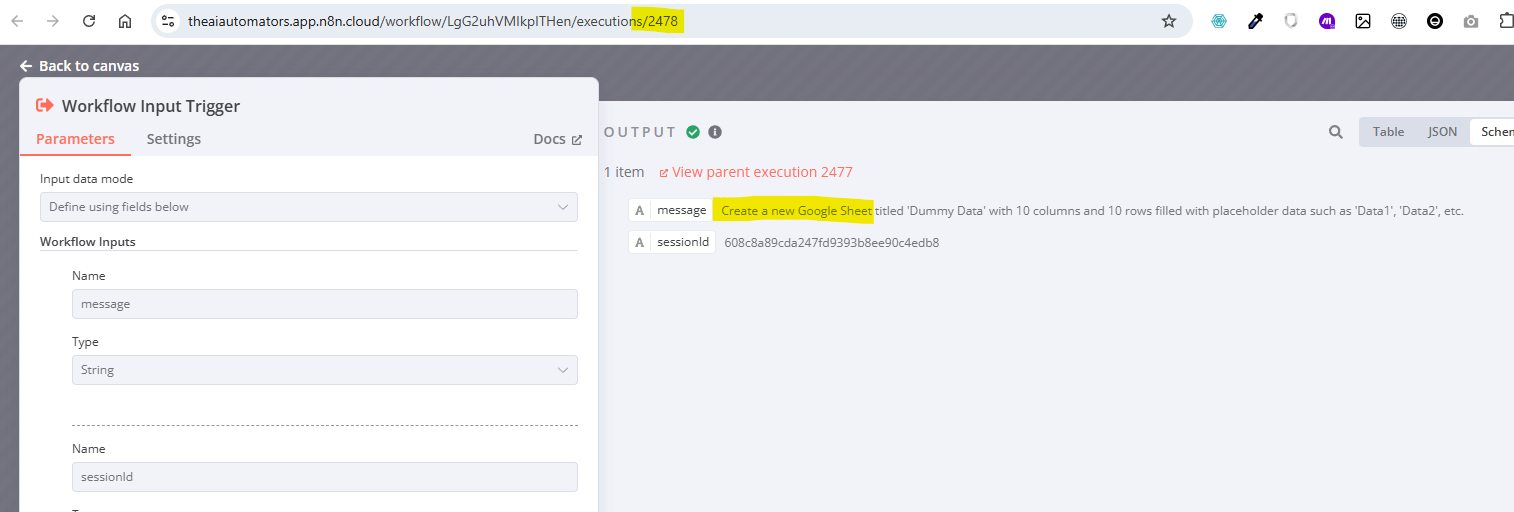

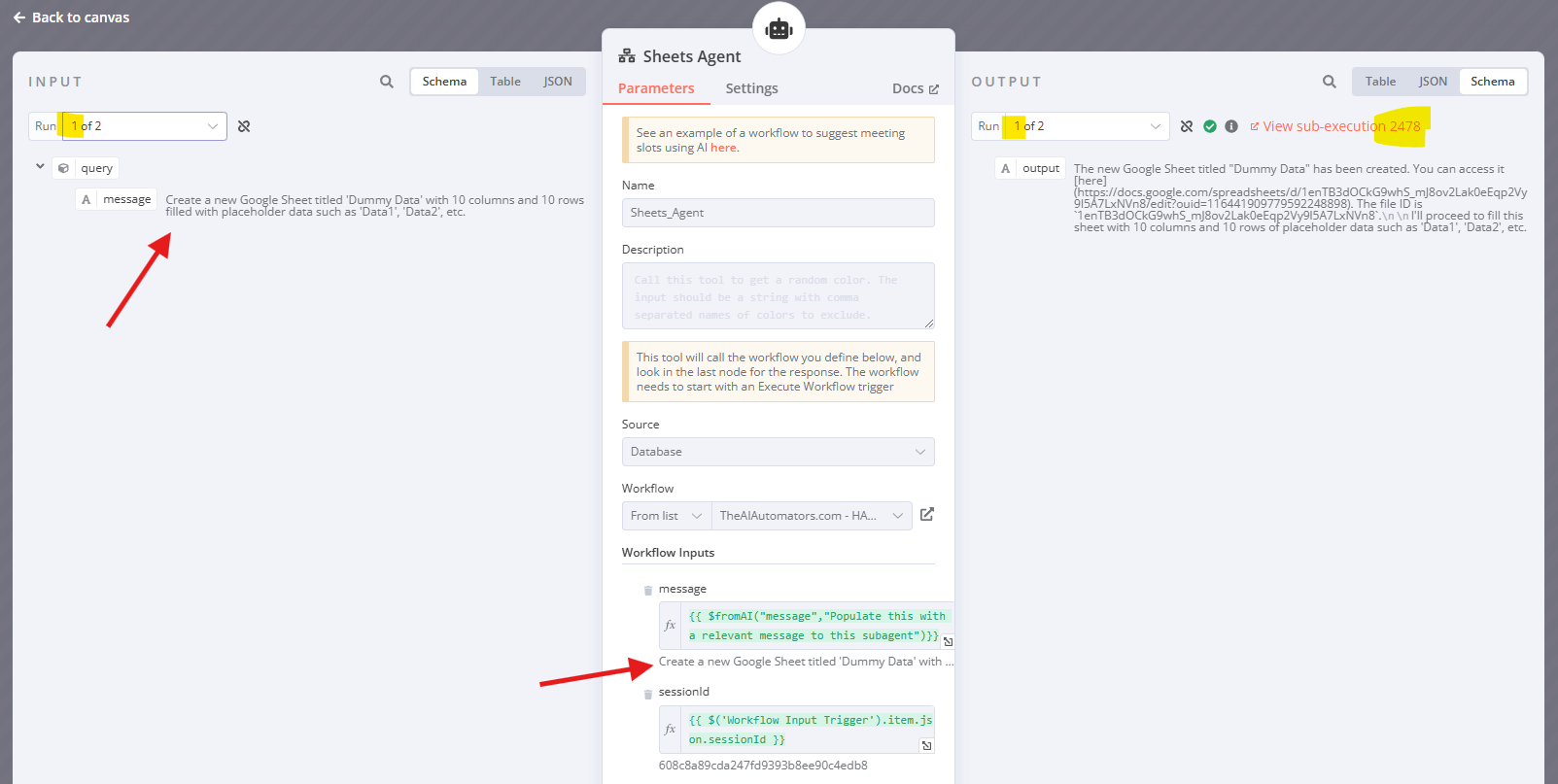

This first call to the Google Sheets agent works fine …
As you can see here

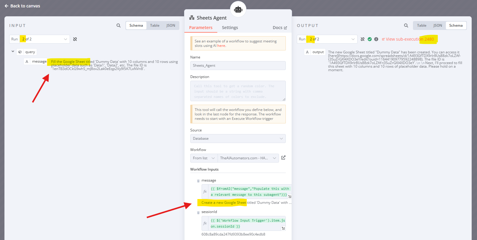

However in the second call
The new message isn’t being passed to the tool - the old message is… as you can see here
This should read … “Fill the Google Sheet titled ‘Dummy Data’ with 10 columns …”
I don’t know is issue a result of the nested nature of the “execute workflows” or if this also happens in a 2 level hierarchy

Hey, thanks for the detailed description! This should be fixed as of v1.76.3, 1.77.1 or 1.78.0. Please let me know if the issue persists on any of these versions.
Brilliant, that worked! Thanks for the quick reply @c6k3
I’ll have to keep my N8N version up to date!
