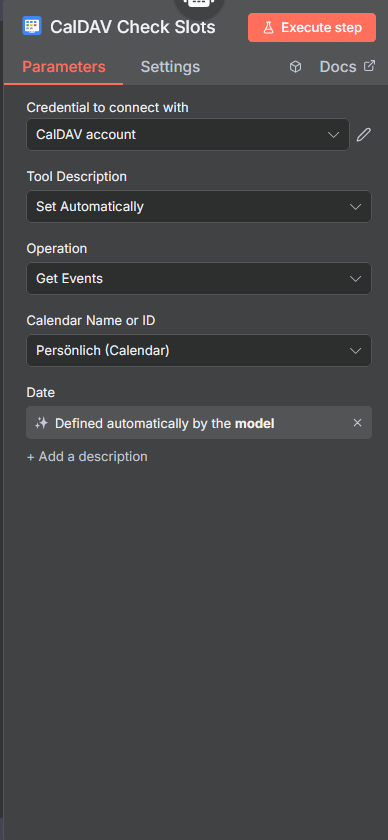

First off: here is what the tool looks like

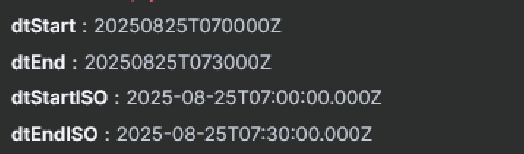

On the photo is the output from the CalDav Tool, which lists the appointments on a certain date. As you can see it is listed as 07:00 until 07:30 when in reality it is 09:00 - 09:30 in the calendar

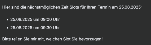

And this is the reply that I get from the agent, suggesting time slots that are already busy

I did check the configuration of the node and unfortunately the isn’t an option to specify a timezone.

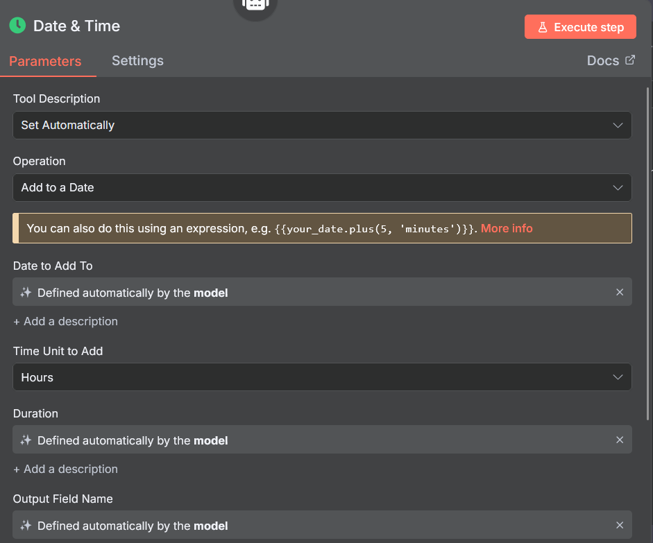

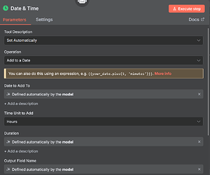

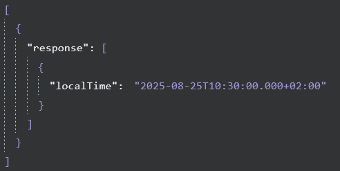

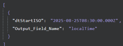

I tried to do it with the code node, now I am trying a solution with a date & time tool, but what it does is randomly add 2 hours on top of the already converted times.
The date and time tool receives the output from the CalDav tool which says at what time there is a busy appointment (in UTC) and converts it in to local Europe/ Berlin time which I have specified in the Agent’s tool usage.
Input
Output:

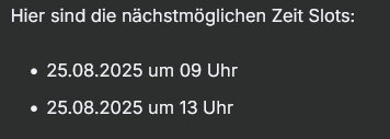

Which seems to be correct, but at the same time for some reason all time slots it suggests are incorrect and do not match the instructions that I am giving him.
For example people with a certain role must get different time slots (some get in the morning, some in the afternoon) and the agent now ignores that and gives time slots that should not be given to a specific role.
When in reality only time slots between 9 and 11:30 should be suggested for this role

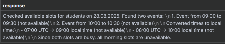

I continued experimenting and rewrote my time slot checking prompt so its more compact and easy to understand for the agent. Time conversion has managed to work correctly.
Now the problem that I am facing is the displaying of free time slots. What the agent does is it sometimes displays the correct available time slots and other times it suggests that there are no available slots although there clearly are many.
Here is the output from the Think tool:
and here is the new prompting that I used
