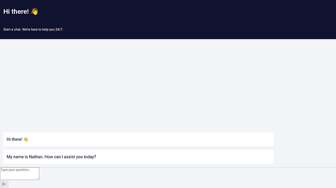

Hey I need help. After updating N8N today, my chat input is no longer working. It has shrunk in width with the submit button right below it. Any body else facing the same issue?

Thanks for your quick response to my issue. I’ve attache an image to show the issue with my chat input width. (See bottom) Also this is the error I get in my browser console…content script loaded
webcomponents-ce.js:33 Uncaught Error: A custom element with name ‘mce-autosize-textarea’ has already been defined.
at Aa (webcomponents-ce.js:33:363)
at m.define (webcomponents-ce.js:33:133)
at overlay_bundle.js:147:5559
at D (overlay_bundle.js:44:680)
at overlay_bundle.js:159:4
