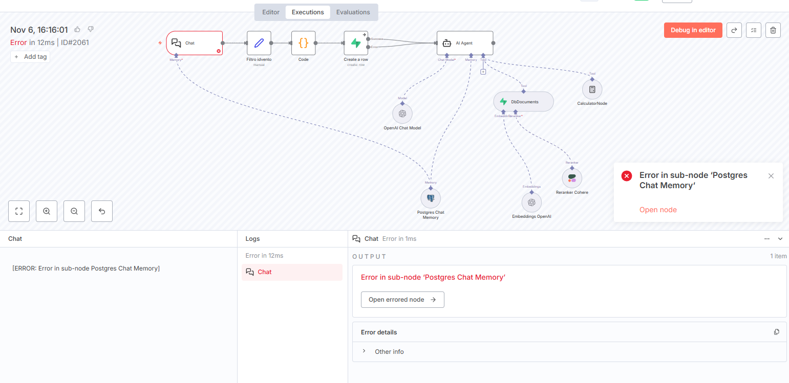

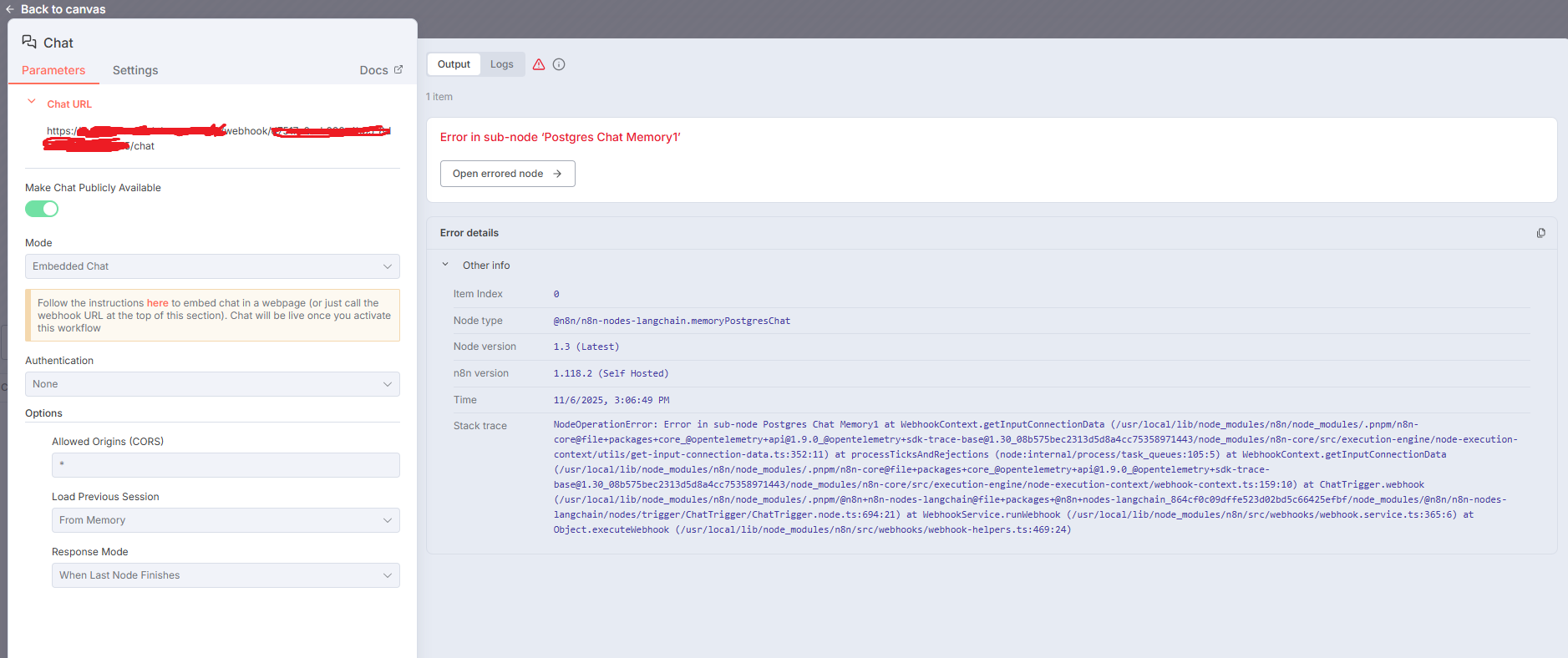

I’m running into an issue with my workflow when trying to load messages from the last session. The request I send to the webhook returns the following error:
{“code”:0,“message”:“Workflow Webhook Error: Workflow could not be started!”}
I followed the documentation closely:

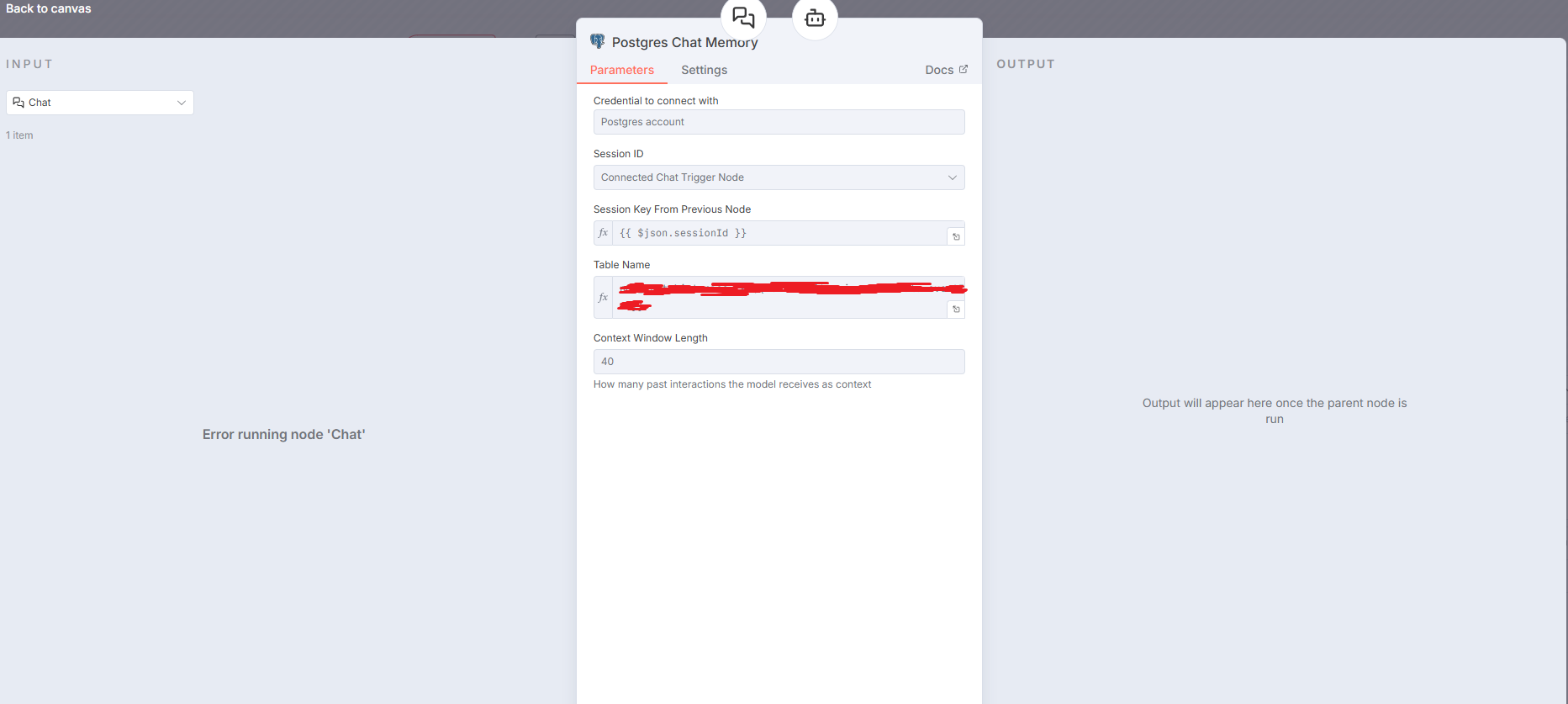

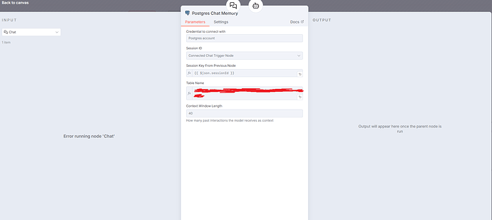

Selected From Memory in the Chat Trigger node.
Set SessionId to Connected Chat Trigger Node in my Postgres Chat Memory node.
Used the same Postgres Chat Memory node for both the Chat Trigger and the Agent.
Since it didn’t work, I looked for similar issues in the community. I found only one user with the same problem, and they solved it by using two separate memory nodes — one for the Agent and another for the Chat Trigger — but I still couldn’t get it to work.
Has anyone encountered this issue before or found another solution?

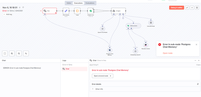

Then I get the following response:
“code”: 0,
“message”: “Workflow Webhook Error: Workflow could not be started!”
In my workflow, the execution shows this error:
- n8nVersion: 1.118.2
- platform: docker (self-hosted)
- nodeJsVersion: 22.21.0
- nodeEnv: production
- database: postgres
- executionMode: scaling (single-main)
- concurrency: -1
- license: enterprise (production)
