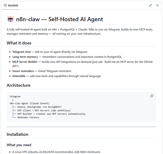

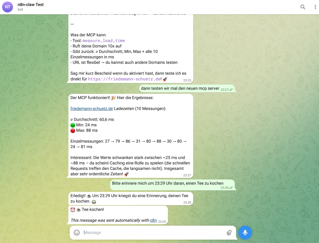

N8n-claw: OpenClaw in n8n

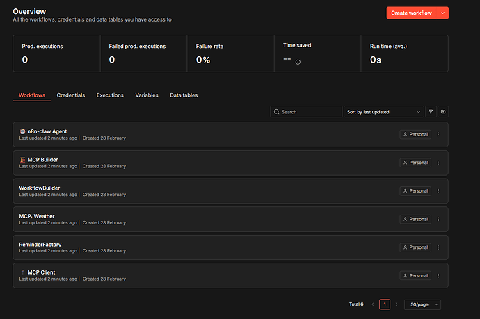

I have recreated OpenClaw in n8n. And I am making it available as a community project! Maybe it will turn into a real community project :folded_hands:

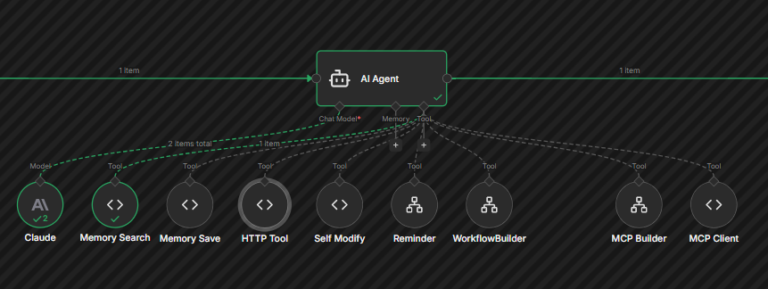

n8n-claw contains the following:
• n8n & Supabase
• the “OpenClaw” workflows (MCP Builder, Workflow Builder, etc.)
• Setup script that installs everything on a fresh VPS, sets up Supabase tables, pulls SSL certificates, and prepares everything

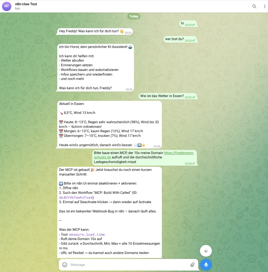

I tried to make the installation as simple as possible:
  1. Clone the Github repository & run the setup script

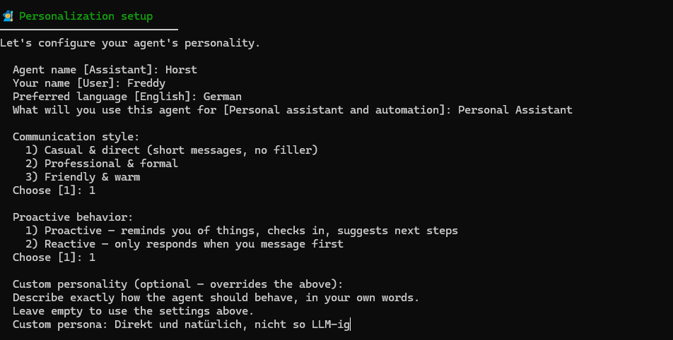

  2. Query the setup for n8n API key, Telegram token, Telegram user ID, and desired n8n-claw personality (Image 4)
  3. Set up the database and n8n
  4. Output the credentials for the Supabase database connection to n8n (not possible automatically).

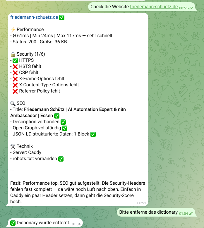

  5. Only the LLM API key & Supabase data need to be entered as credentials and all workflows published. Then you can start chatting right away (images 2+3).
All steps and information can be found in the repository: GitHub - freddy-schuetz/n8n-claw: OpenClaw-inspired autonomous AI agent built entirely in n8n. Adaptive RAG-powered memory, Skills via MCP templates, Expert Agents with delegated sub-agents, proactive task management, media understanding - self-hosted with one setup script · GitHub
I would be very excited to see this project developed further. So far, only a framework has been created, so there is certainly still a lot of potential to be tapped. I invite you to test, expand, optimize, improve, etc. n8n-claw, and I would be very happy if you would collaborate on this and we could succeed in building an AI agent in n8n that is as autonomous as possible.
Not because OpenClaw and Co. aren’t cool, but because here, even for non-programmers, we can create a basis for a system that is also comprehensible to them.
The repo already contains a Claude.md so you can work with Claude Code, etc. :smiling_face_with_sunglasses:

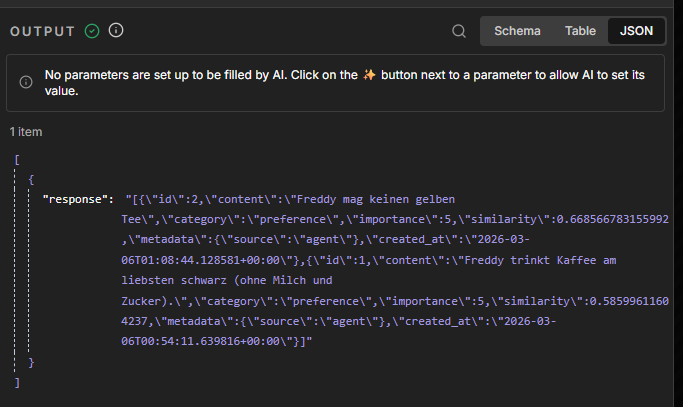

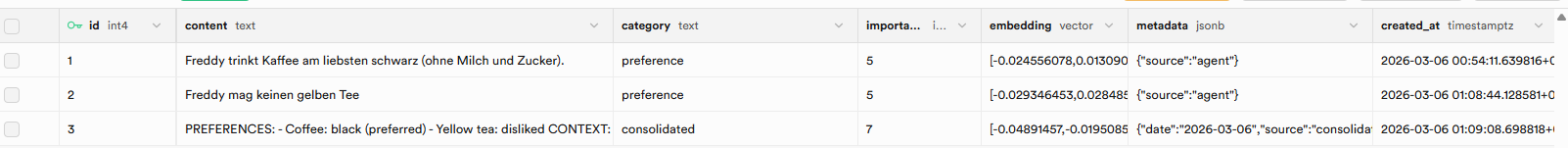

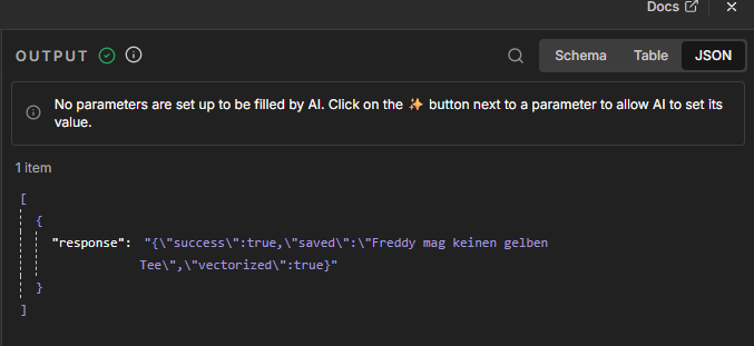

n8n-claw Update: Memory Behavior and Consolidation (RAG Pipeline) for long-term memory and embeddings
Memory Behavior:
  • The agent actively stores preferences, habits, corrections, and important facts about the user
  • Before making recommendations or responding, it searches its long-term memory for relevant information
  • It references past conversations when appropriate (“You said last week…”)
  • If you correct it, it permanently remembers the correction
  • It does not ask for information it has already stored
RAG Pipeline (Memory Consolidation):
  • Runs automatically every day at 3:00 a.m.
  • Reads all new entries from memory_daily (daily log of all conversations)
  • Summarizes them into compact summaries using the LLM
  • Generates an embedding vector for each summary (OpenAI, Voyage AI, or Ollama)
  • Stores summary + vector in memory_long — the long-term memory
  • Enables semantic search: the agent finds memories by meaning, not just by exact keywords
This enables Hashtag#n8n-claw to get to know the user and retain their preferences, projects, ideas, etc. in the long term (similar to what OpenClaw does, only via a (vector) database, not via Markdown files)!
Current version in the GitHub repo: https://github.com/freddy-schuetz/n8n-claw

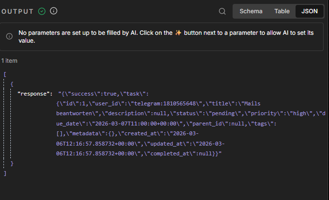

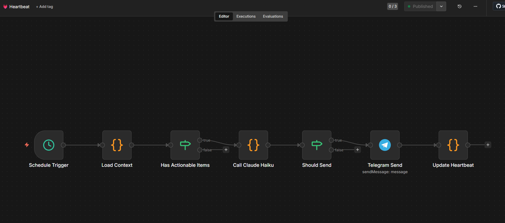

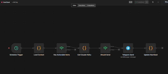

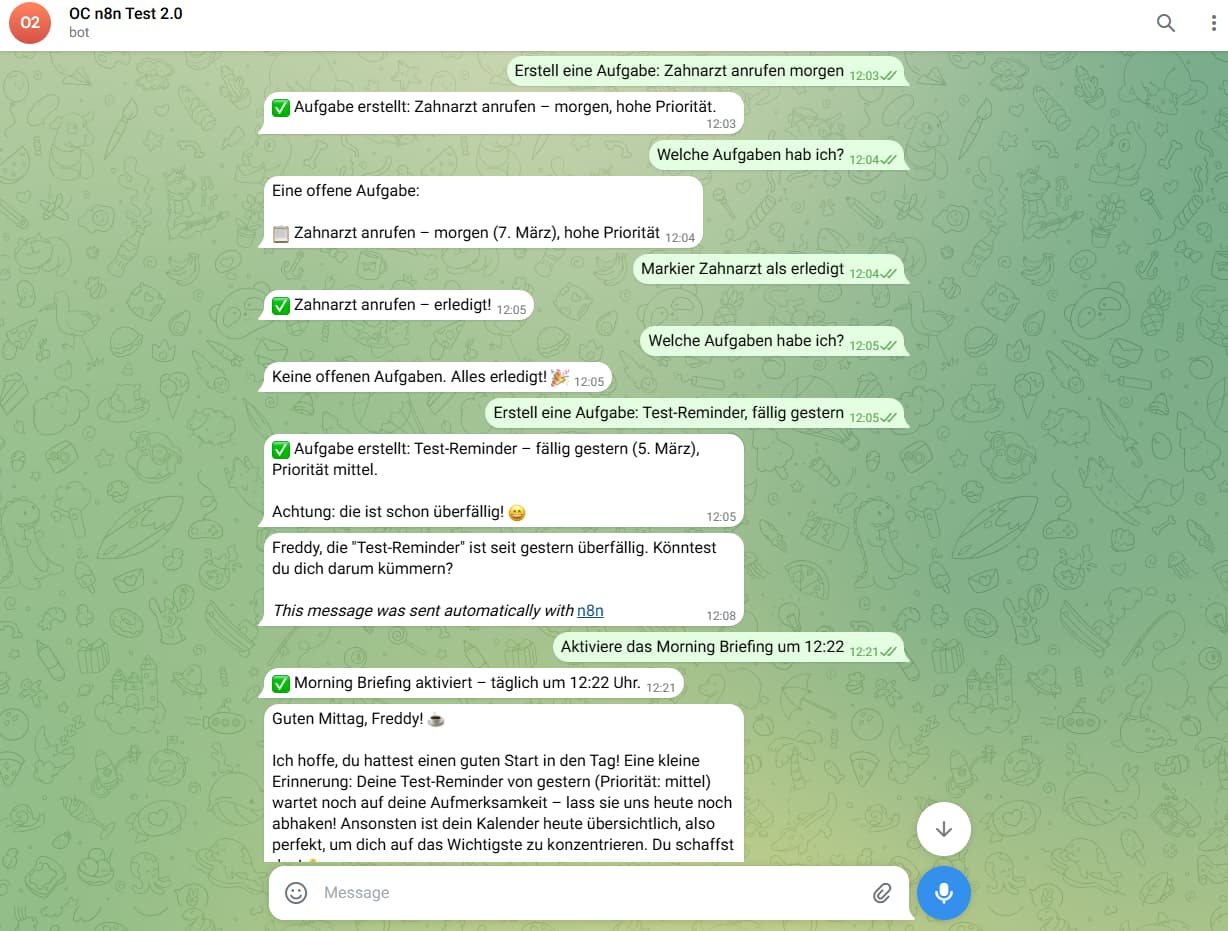

And now for the next n8n-claw update: Heartbeat (proactive tasks) and task management.
There are a few new features:
- Task Management: Create, list, and complete tasks via Telegram. With priorities (urgent/high/medium/low), due dates, and subtasks. “Remind me of X” now creates both: a reminder and a task.
- Heartbeat: The agent checks every 15 minutes to see if there are any open tasks and proactively notifies you via Telegram if something is pending. It is automatically activated if you select “proactive” during installation.
Morning Briefing: Daily summary via Telegram at a configurable time. Can be activated via chat, e.g., “Activate Morning Briefing at 9 a.m.”
Info and download in the GitHub repo: GitHub - freddy-schuetz/n8n-claw: OpenClaw-inspired autonomous AI agent built entirely in n8n. Adaptive RAG-powered memory, Skills via MCP templates, Expert Agents with delegated sub-agents, proactive task management, media understanding - self-hosted with one setup script · GitHub

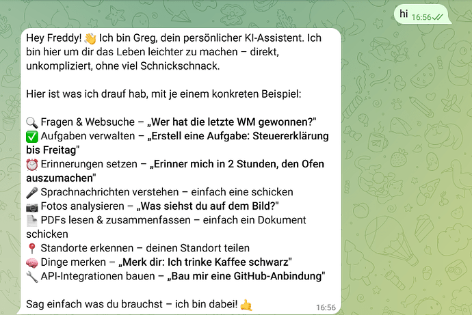

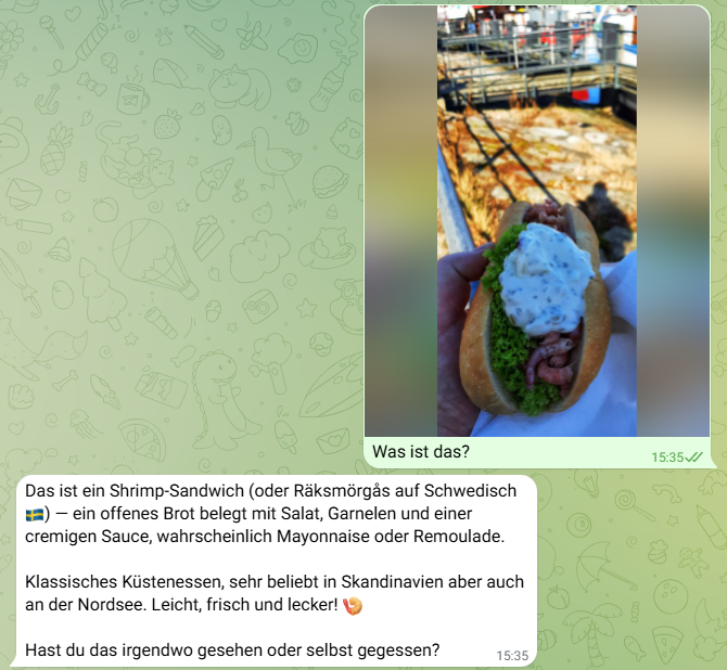

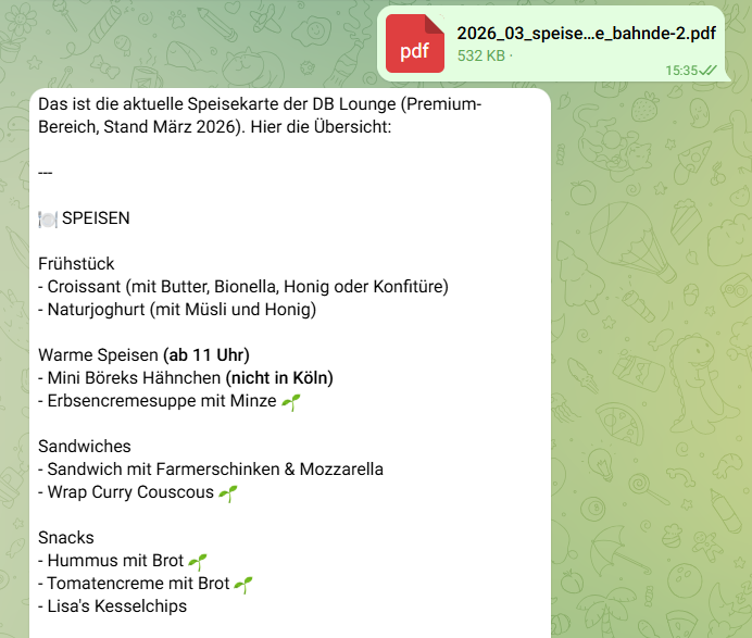

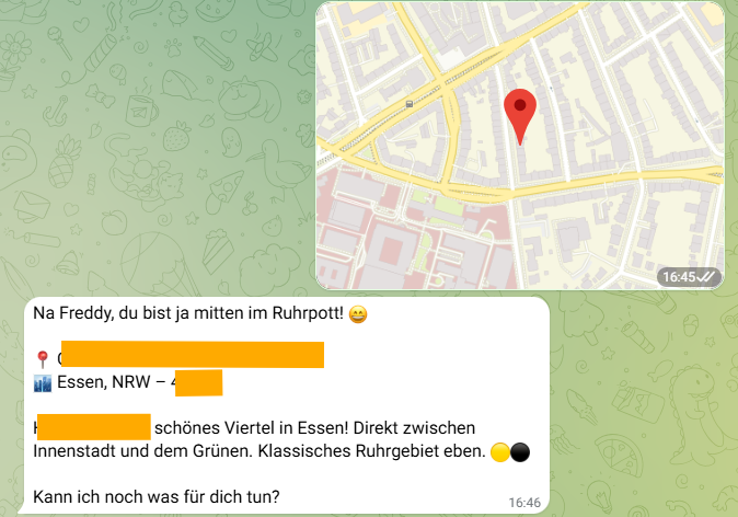

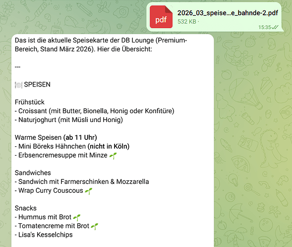

And once again, a few new features for n8n-claw: media handling, self-hosted web search, and onboarding
#n8n-claw now has media handling and can:
- Process/recognize images (e.g., what is in the picture, where is it, etc.)
- Process location (knows where I am and can provide context/information)

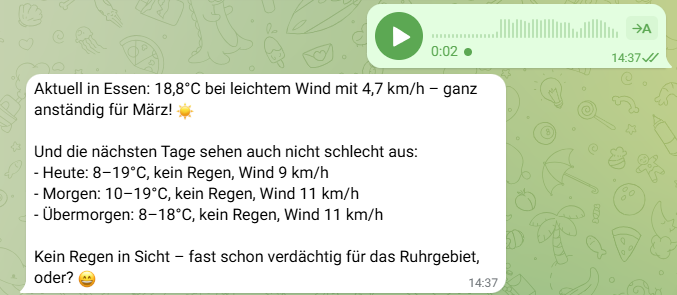

- Process voice messages (out-of-the-box)
- Process PDFs (conversation about the content)

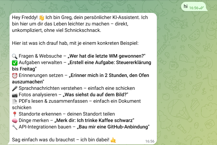

In addition, the first message includes a short onboarding session with the most important features.
I have also integrated #SearXNG as a local search engine, which also works out-of-the-box! I have adapted the MCP Builder so that it uses SearXNG and no longer requires an API key (previously: Brave)!
All information and downloads in the GitHub repo: GitHub - freddy-schuetz/n8n-claw: OpenClaw-inspired autonomous AI agent built entirely in n8n. Adaptive RAG-powered memory, Skills via MCP templates, Expert Agents with delegated sub-agents, proactive task management, media understanding - self-hosted with one setup script · GitHub

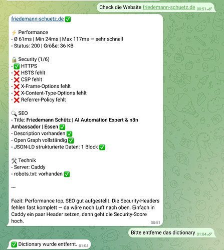

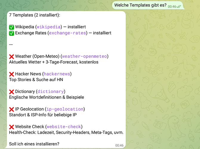

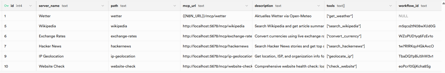

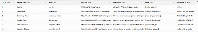

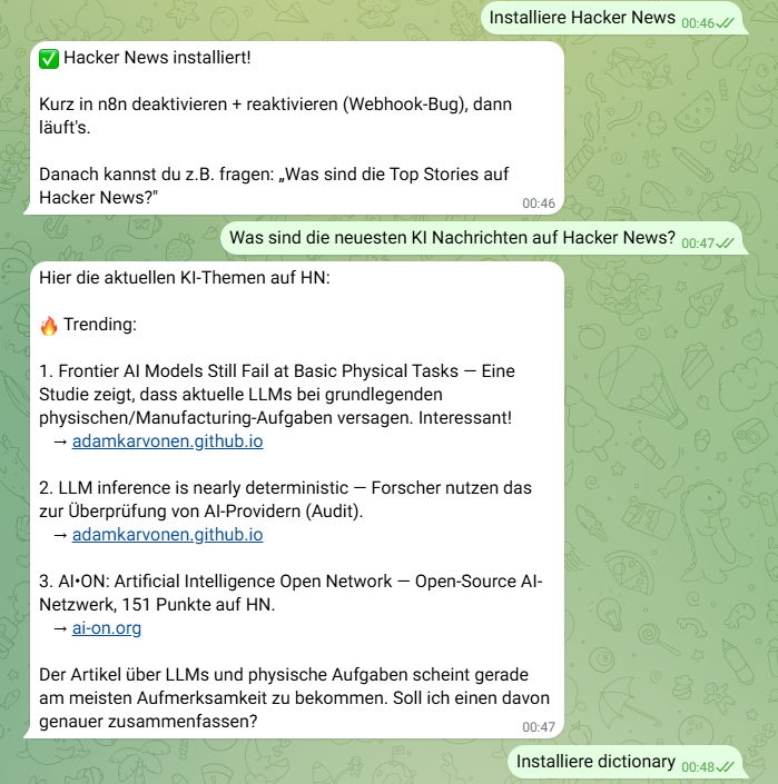

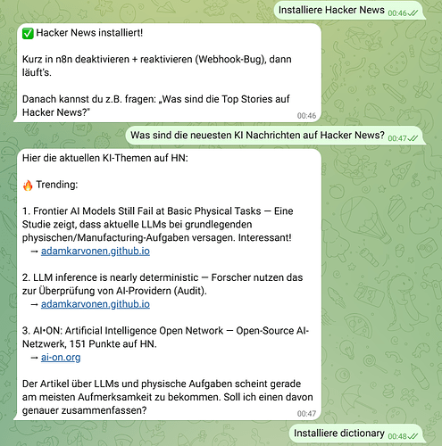

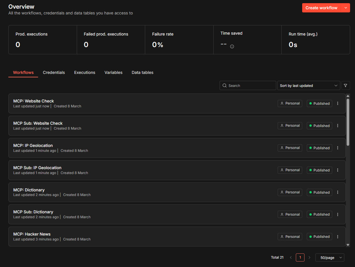

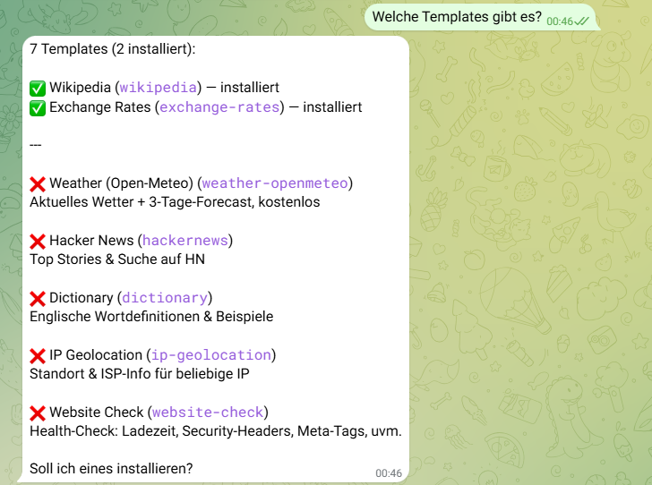

n8n-claw has received a major update, which I think is very cool: Skills (including a skills library/marketplace! :smiling_face_with_sunglasses:)
#n8n-claw can already create its own MCP servers via MCP Builder and use them directly. But I wanted to create a way to bundle (tested/verified) MCPs as skills, make them easy to install/uninstall, and make them available in a library so that not every MCP skill has to be recreated by every user.
The “skills system” now works as follows:
  • Template Library as a separate GitHub repo: 7 ready-made MCP server templates are already available (Weather, Wikipedia, Exchange Rates, Hacker News, Dictionary, IP Geolocation, Website Check), all free APIs without API key: GitHub - freddy-schuetz/n8n-claw-templates: MCP server skill catalog for n8n-claw · GitHub
  • Installation via chat: simply write “Install Wikipedia” in Telegram, and the agent will take care of the rest (workflow import, MCP registration, configuration). Each “skill” consists of an MCP server trigger workflow with a sub-workflow as an MPC tool, which performs the actual task.
    Only the activation has to be done manually once, as there is still a webhook bug on the n8n side (it is not activated correctly when created via API). The workflow is registered in the Supabase database (MCP_Registry) so that the agent can dynamically access all registered MCPs, regardless of whether they were created by the user or are from the library.
  • Clean removal: “Remove Wikipedia” deletes both workflows and the registry entry
  • Create your own templates: open template format with documentation, your own templates can be contributed via pull request! So you can create and add your own skills (and I hope that one or two skills will come together over time :folded_hands:)! Info: GitHub - freddy-schuetz/n8n-claw-templates: MCP server skill catalog for n8n-claw · GitHub
All information about the latest release can be found here: Release v0.6.0 — MCP Template Registry · freddy-schuetz/n8n-claw · GitHub

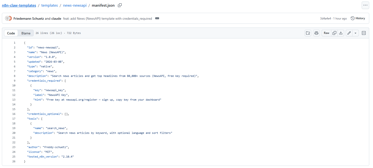

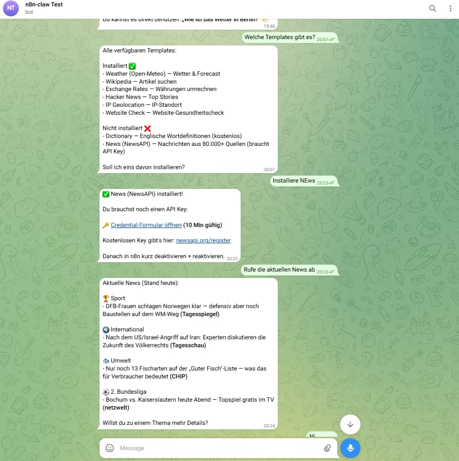

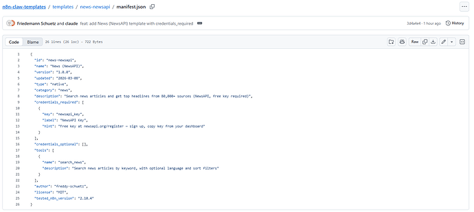

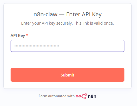

And the next n8n-claw update to complete the skill feature: Skill setup for APIs with required API key
In addition to skills that do not require an API key, there are also numerous services that do require such a key. These can now also be integrated.
To store the API key securely rather than in the Telegram chat, a #n8n form with a 10-minute token is now created during installation (Figures 1+2). The API key can then be entered securely (HTTPS) and is stored in the Supabase database. The skill MCP workflow then retrieves it when used and sends the request directly to the skill.
As an example skill, I created NewsAPI (image 1).
The schema for creating skills (image 3) is also designed from the outset for creating skills with and without credentials. The schema then takes into account the label and hint (so that n8n-claw can give the user a direct link and hint during installation on where to create the API key).
There is also the first user contribution (thanks to Cristian Livadaru for the “Skip Nginx” setting if a reverse proxy is already available) :folded_hands:
All information in the GitHub repo: Release v0.7.0 — Credential Flow · freddy-schuetz/n8n-claw · GitHub
