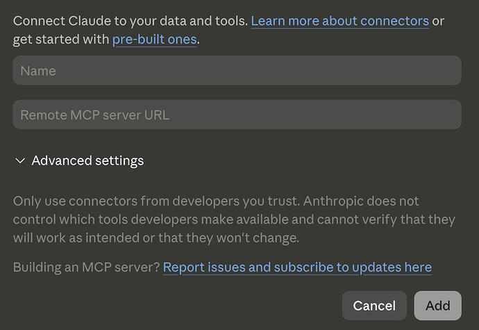

Firstly i wanna make sure you have the claude desktop app and also have a paid plan which gives you access to claude code.
And then you can navigate to claudecode</> → customize → browse connectors → Then search for n8n there an official connector would come up and then you just have to enter the name of your choice and then navigate to n8n activate the instance level MCP then collect the MCP server URL and paste it below the enter name field.
You would only get 2 fields like this :
And then you just have to click add and it will be connected, once it is then just configure some permissions and in your n8n instance enable the workflows you wanna integrate with claude code with MCP.
If you face any problems with this let me know, I hope this helps.

Unfortunately, that’s exactly what doesn’t work and triggers the error message in Claude.
