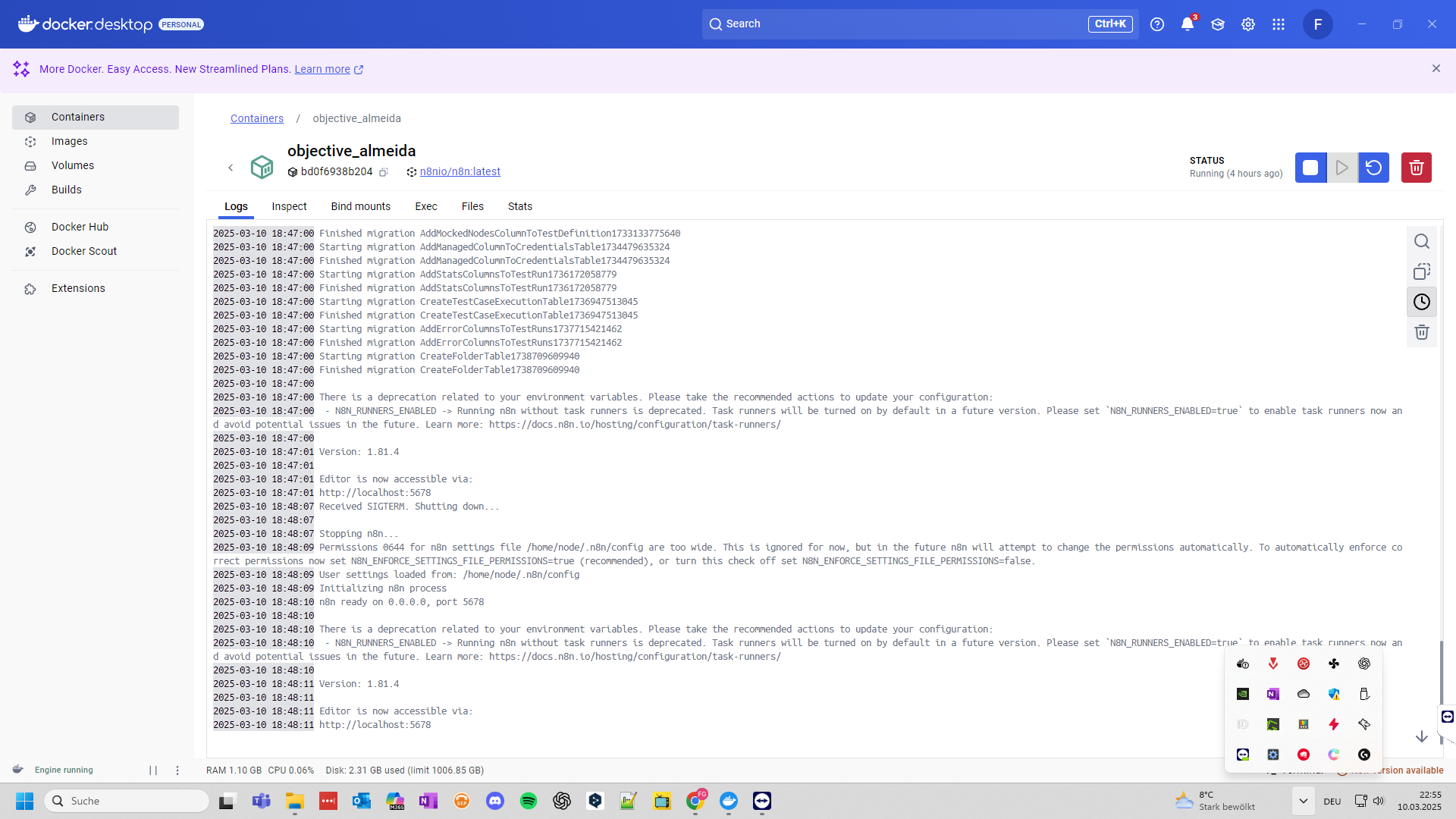

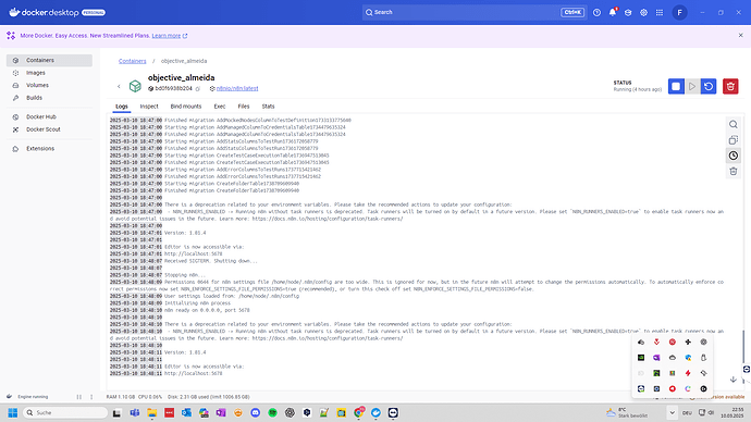

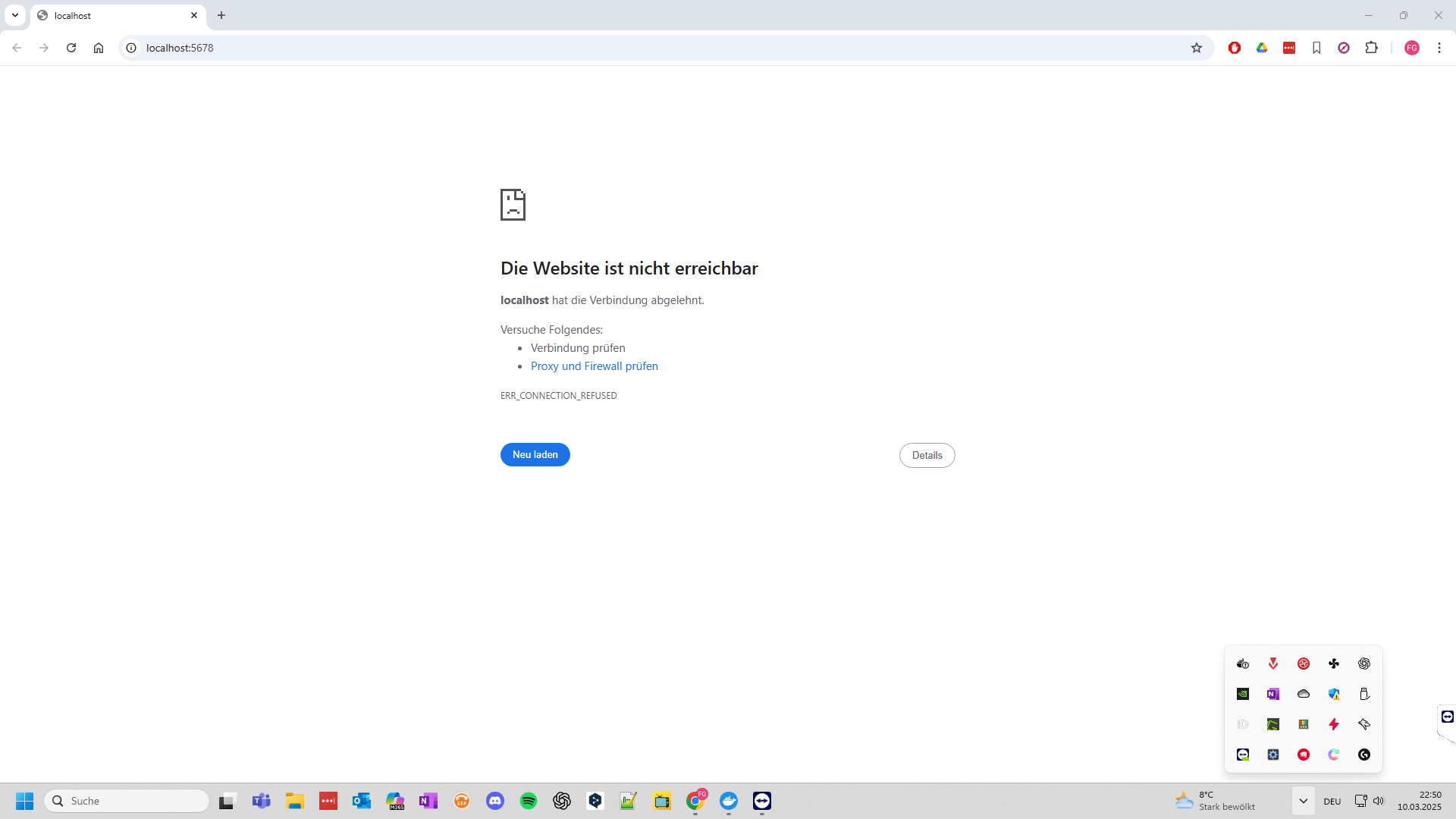

Yesterday I’ve setup n8n docker container. It was running perfeclty fine. Today I’ve startet up the container, in log it says: “Editor is now accessible via: http://localhost:5678” but when I open it in browser the site is not available.

  2. Use Chrome browser
  3. Try 127.0.0.1:5678

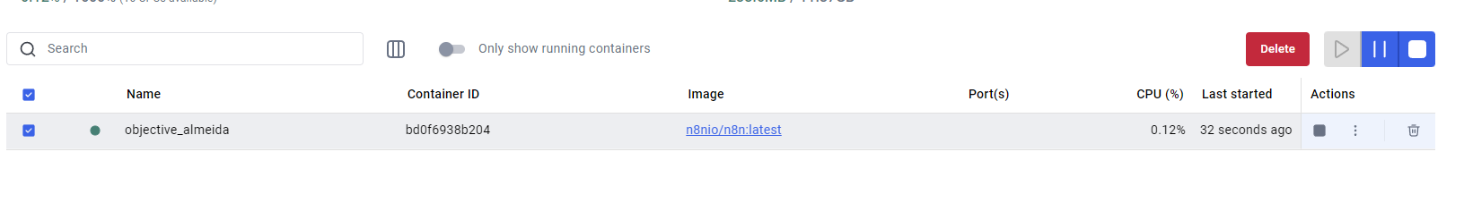

Looks like I didnt add the port in docker:
how to add it?

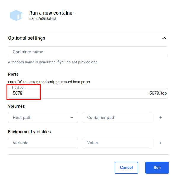

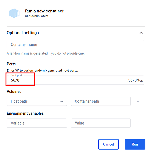

When you click the arrow at your images to start a new container, you are presented with a popup, you have to open the additional settings, there you find the port field.
  1. remove you current container
  2. go to your images
  3. click run for the correct image
  4. open additional settings
  5. Field ‘Host Port’, add 5678
  6. Click run
