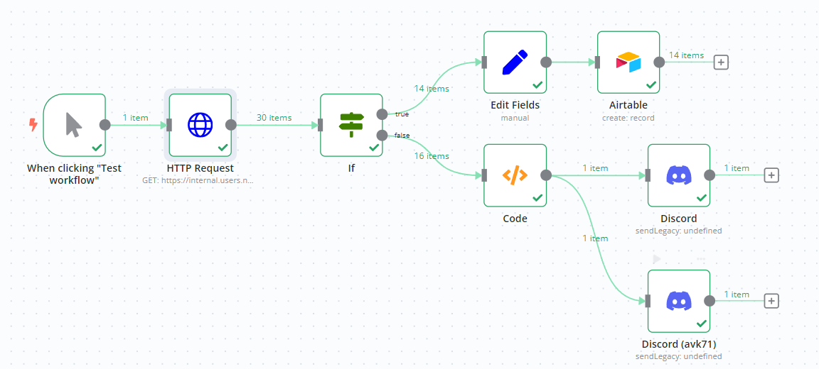

Just have found the root cause of my problem. As to Notifying the team | n8n Docs explanation, the formula for Unique ID is {{ $(‘HTTP Request’).params[“headerParameters”][“parameters”][0][“value”] }}.
But that formula gets Header Auth value, not Unique ID value.

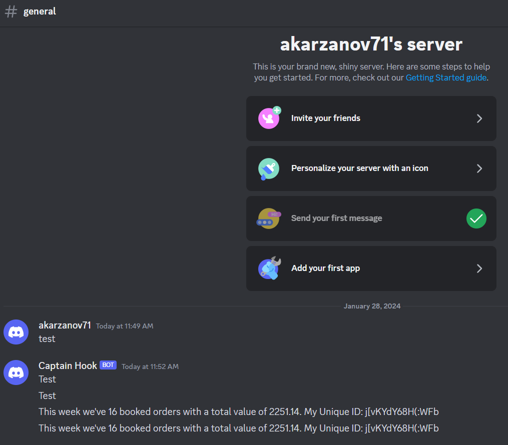

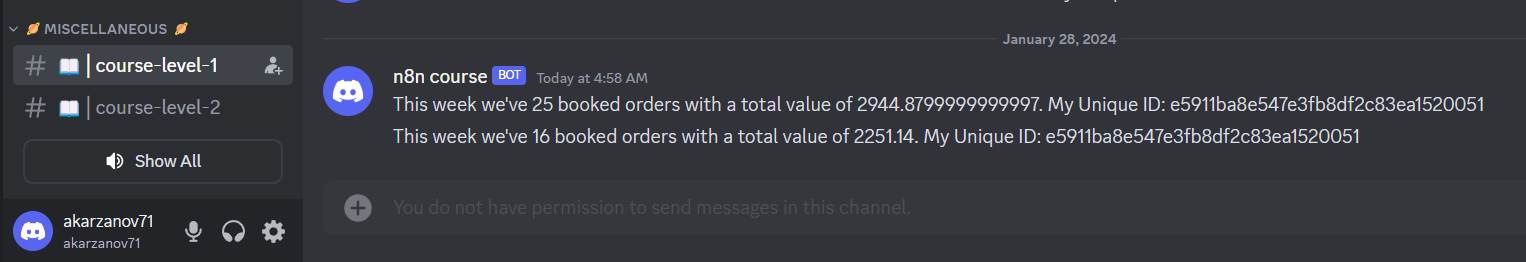

So I hard-coded Unique ID value from the e-mail received from n8n and this time the message has succesfully showed up on n8n course-level-1 channel.

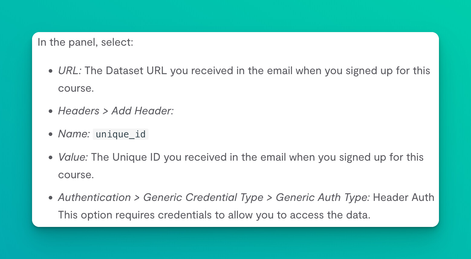

That expression looks to be correct, In the first part of the course it asks you to add the unique id as a header for the node is it possible that you missed this step or tried to do something else?

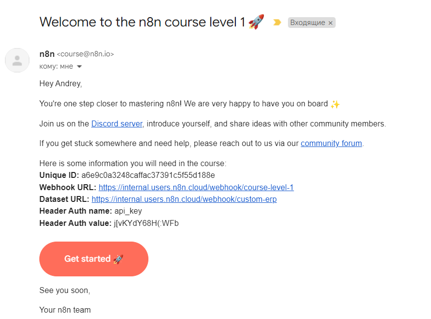

As you can see in the attached screenshot from n8n couse-level-1 Welcome e-mail, Unique ID is a 32-character string, but Header Auth value is a 15-character string, so they values are different. {{ $(‘HTTP Request’).params[“headerParameters”][“parameters”][0][“value”] }} returns Header Auth value, but Discord channel bot allows only messages with Unique ID, and drops them otherwise.

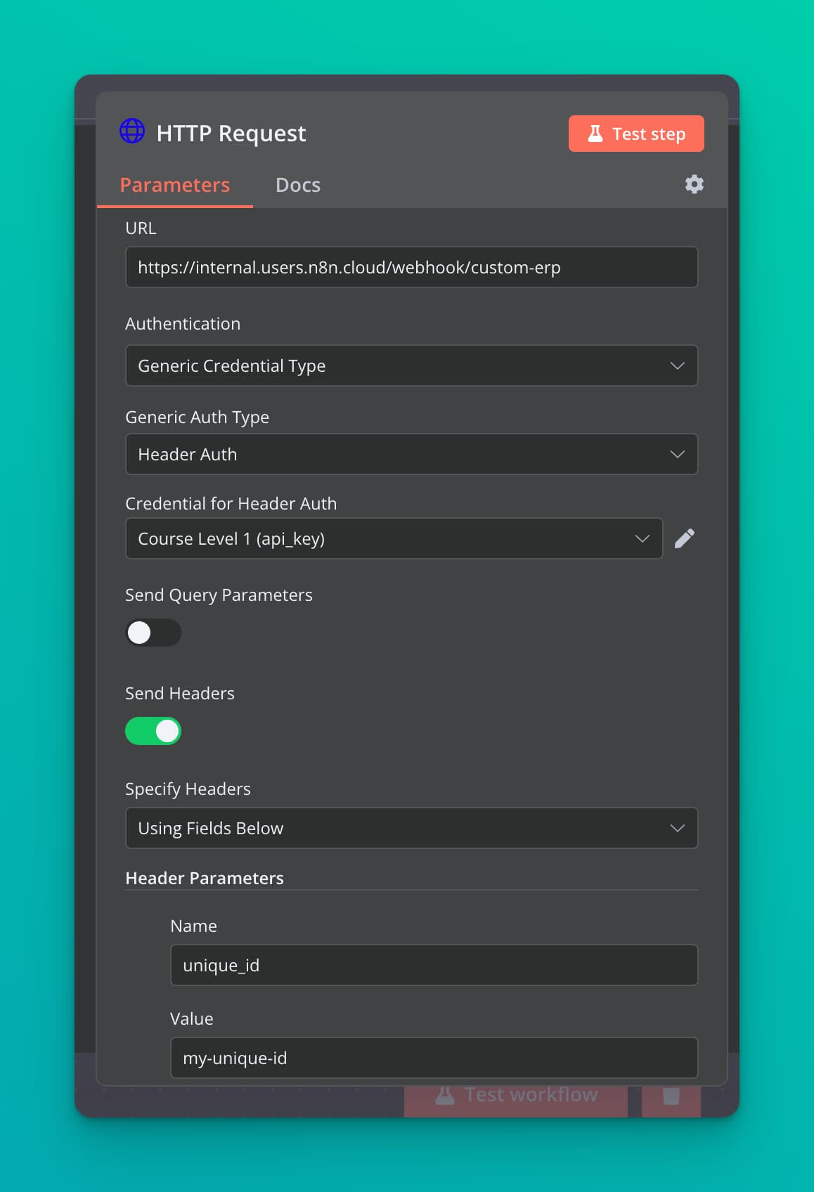

Both values are different, So you should be creating a credential with a header type for api_key but for unique id it should be set in the first http request node as a header value.

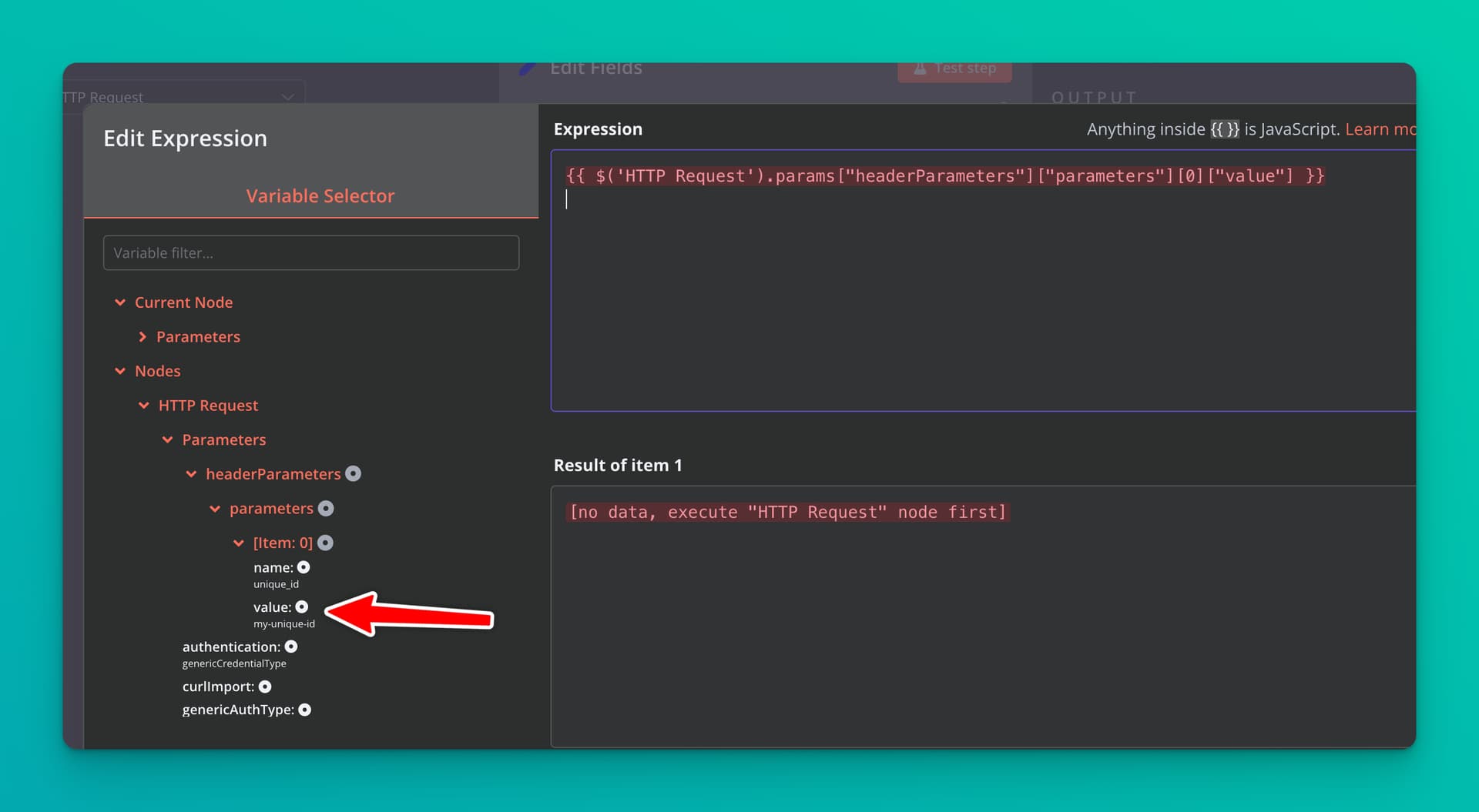

The idea is to use the value inputted as a header parameter here and the path for that is {{ $('HTTP Request').params["headerParameters"]["parameters"][0]["value"] }}
This can also be checked in the expression editor here…
I suspect in some of the cases the first step has not been correctly followed or misunderstood although we did change that expression a couple of months ago as well so it was wrong for a while.
