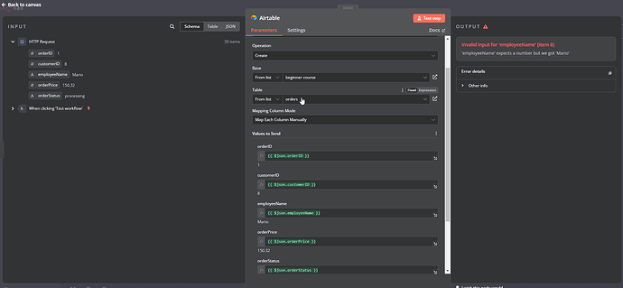

Hello, here trying to complete the airtable node, I get an error “Invalid input for ‘employeeName’ [item 0].
‘employeeName’ expects a number but we got ‘Mario’”, I understand that according to what it says should go a number in that box, but in the exercise of the example image of the course indicate that there goes the name, that could be causing this error.

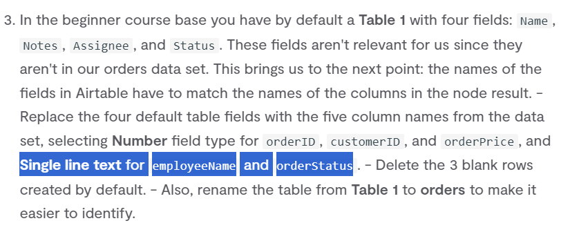

That’s because you didn’t set the field type text for the field employeeName
thank you very much…the error was solved, greetings
