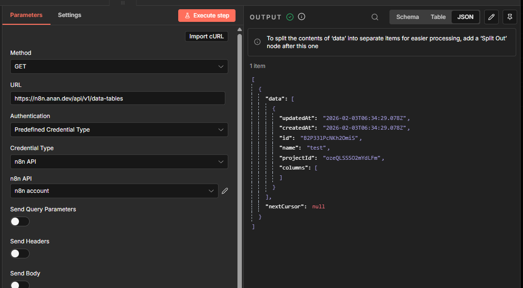

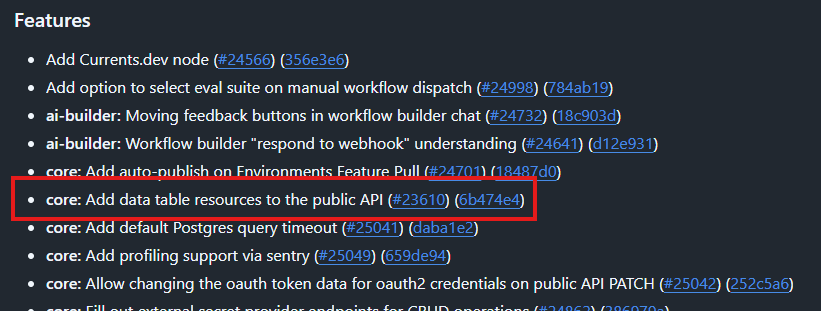

Hi @Sandeep, welcome!
This is working in v2.7.0
Thank you @mohamed3nan for your quick reply. We will update our N8N version accordingly.
