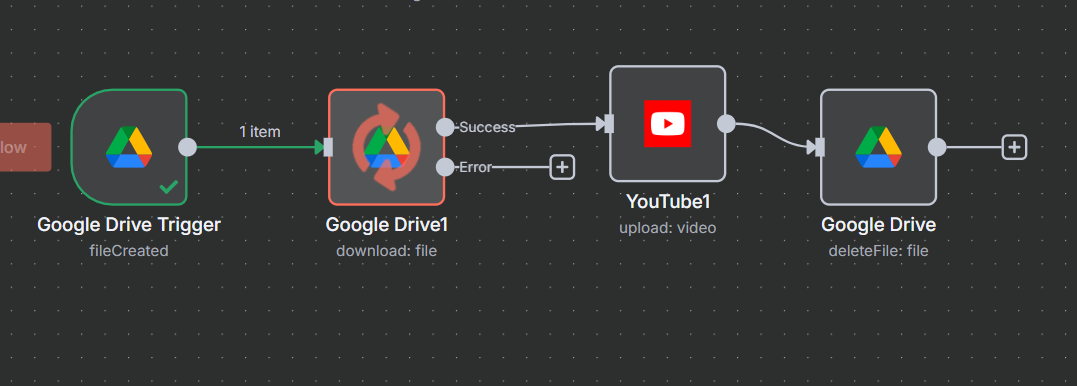

N8N_DEFAULT_BINARY_DATA_MODE=filesystem does not take effect
Hi,
i have setup a hetzner docker installation like described here: Hetzner | n8n Docs
Now i was making a workflow by downloading a file (~3GB) on google drive and then send this to youtube.
My server only has 4GB of RAM, so i thought i am setting up N8N_DEFAULT_BINARY_DATA_MODE=filesystem like found in many topics.
But it does not have an effect, it still uses the RAM.
What i did
  • changed .env
  • changed docker-compose.yml
  • docker compose up -d --build
Output is " n8n may have run out of memory while running this execution. More context and tips on how to avoid this in the docs"
  • n8n version: 1.95.3
  • Operating system: Linux

Hi!
  1. done, its in the .env
  2. docker-compose.yml is also fine (see below)
  3. ok, what do you want to say? the folder is there and writable (from older smaller files)
  4. thanks, tried that now too
  5. Verification was fine
here is the docker-compose.yml (unchanged from n8n exception the added env variables)

Still its NOT working. I did not change anything in the container so permissions must be good, right?
Is there any error log i can see maybe?
I dont understand, why its using memory still :frowning:
I understand it that way, that it takes “max_old_space_size” as maximum RAM usage, then writes the file.
Or n8n writes directly, also ok.
But in both cases it shall work, right?
Here is also a screenshot of my server, when downlading the video from Google Drive.
It just stops at short before maximum RAM, process is still running for like 1-2 minutes and then its canceled at some point.

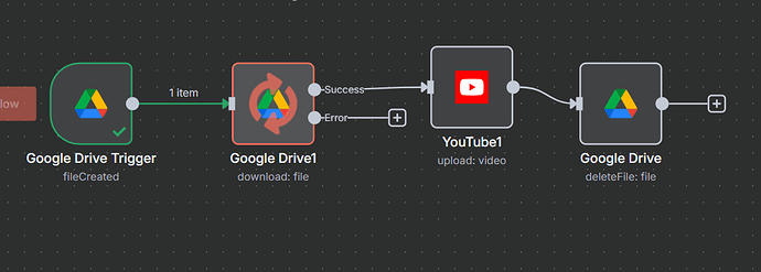

Hi!
Its still not working.
I have updated to the current version a few weeks later, i thought maybe it works now, but its not.
This is the output from the CLI
And here you can see the process (htop)
So you see, its still getting that the var is changed, but Google Drive file download still uses just RAM at this point.
Why is that?
Also you can see that in the binaryData folder no files are written.
PS: Or is the error in the Google Drive node? Is that possible?
Partially ashamed i am now posting myself the answer :rofl:
Its working correctly, the problem is the Google Drive download, which is simply ignoring the setting.
I now solved this via HTTP Request and then could upload the video to youtube.
RAM is not nearly at maximum now and server is not lagging at all.
Sorry for disturbing.
Whoever develops the Google Drive node shall really work on this because i think this could make life much easier.
FYI: I now realised this via a direct link: https://drive.usercontent.google.com/download?id={{ $json.id }}&export=download&confirm=t&uuid=n8n
This is working for now, its also ignoring the “Can not be scanned by virus scan” message because i am faking a uuid and confirm value.
