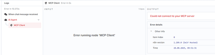

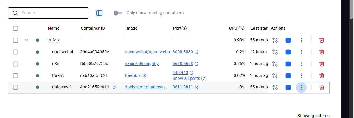

N8N does not see my MCP server from docker MCP toolkit. I have both (n8n + MCP) working at the same docker network. Also i have exposed port to my local PC to make sure the container works and it does
Docker container name: gateway-1

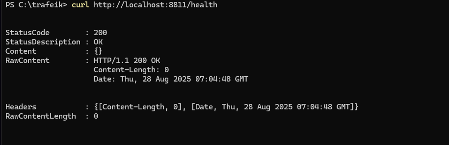

Locally it does work at http://localhost:8811/sse
curl http://localhost:8811/health returns 200
N8N does not connect with address https://gateway-1:8811/sse
Also not working with http://host.docker.internal:8811/sse

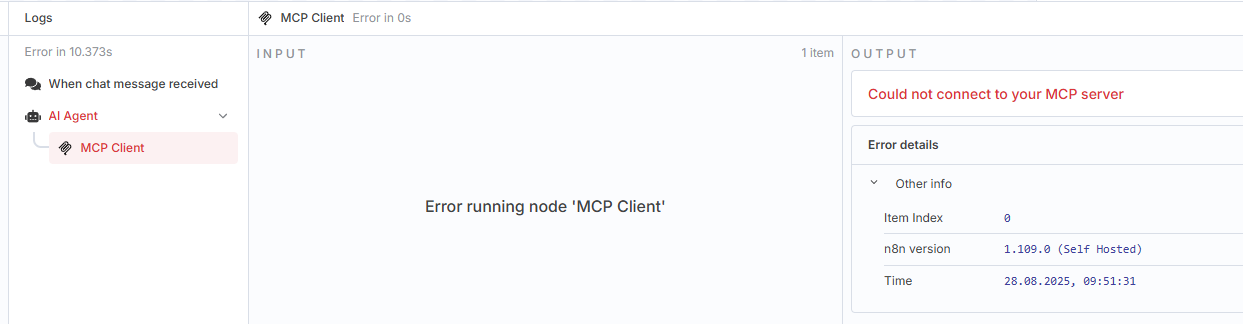

Could not connect to your MCP server

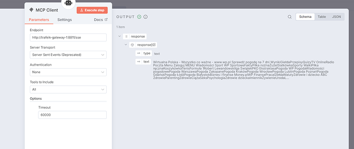

, its been a while so i don’t remember exactly what i did step by step, but it looks like this now. Pleas note that i almost don’t use this setup anymore, so it could be wrongly configured and i haven’t even noticed: Basically all my containers works within the same docker network (Edge) (see th compose file below) and from n8n I’ve set it up so it would talk internally to the docker gateway. so it should alos work like this:
http://gateway:8811/sse
n8n MCP node configuration:
