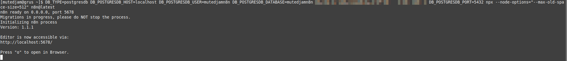

Hi @SkyIsTheLimit, you could consider using Postgres instead if sqlite causes trouble. Once set up using the instructions provided by Ubserspace n8n starts fine. I just tested this:
The exact command was this:
DB_TYPE=postgresdb DB_POSTGRESDB_HOST=localhost DB_POSTGRESDB_USER=mutedjamn8n DB_POSTGRESDB_DATABASE=mutedjamn8n DB_POSTGRESDB_PASSWORD=myDatabasePassword DB_POSTGRESDB_PORT=5432 npx --node-options="--max-old-space-size=512" n8n@latest
That said it seems Uberspace kills processes if they use too much memory on the host and I suspect this might also happen in other situations. Unfortunately as a user it won’t be easily possible to identify what happened as you can’t access the pacct file (which makes sense for security reason, seeing an Ubserspace host is shared by many users). Docker is also unavailable on Uberspace.
