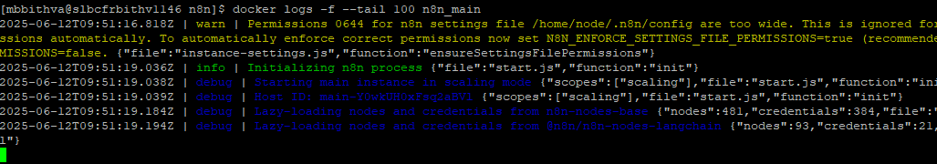

Since n8n 1.97.0 when I install n8n via docker-compose n8n not start. When I go back to n8n 1.95.3 I don’t have any problem n8n start correctly and I don’t do specific between 1.95.3 and .198.0 or 1.97.0.
I don’t have any error but after initi process n8n nothing append, it doesn’t expose port 5678. my docker-compose is extactly the same between 1.95.3 and 1.98.0 (except the n8n version of course) but in 1.97.0 or 1.98.0 n8n is stucked.
Any idea ? Help very appreciate.
