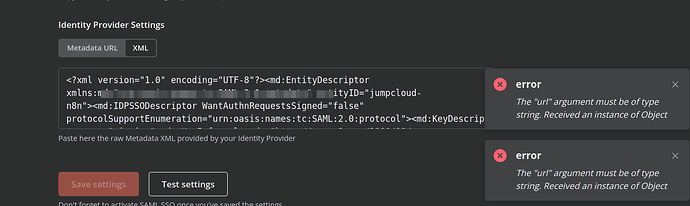

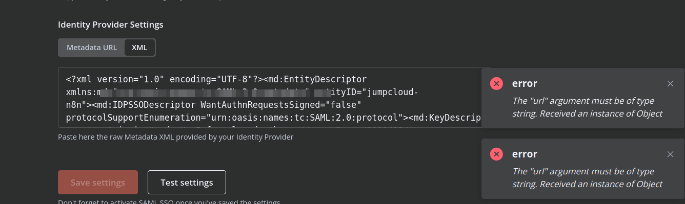

Hi @ria , thanks for reply!
Below, I’ve included evidence of the error and how I’m sending the configuration:
Using URL
Using XML
If you need more information, let me know.strong text

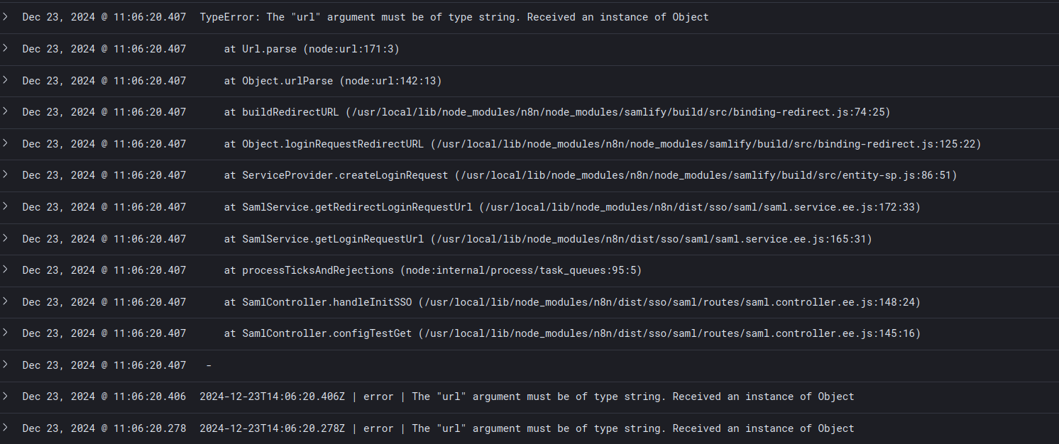

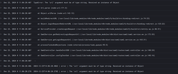

Hi @ria , the same error
Logs:
Dec 23, 2024 @ 11:06:20.407TypeError: The “url” argument must be of type string. Received an instance of Object

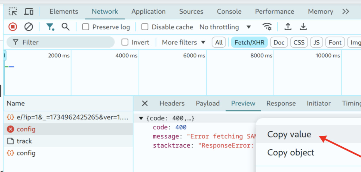

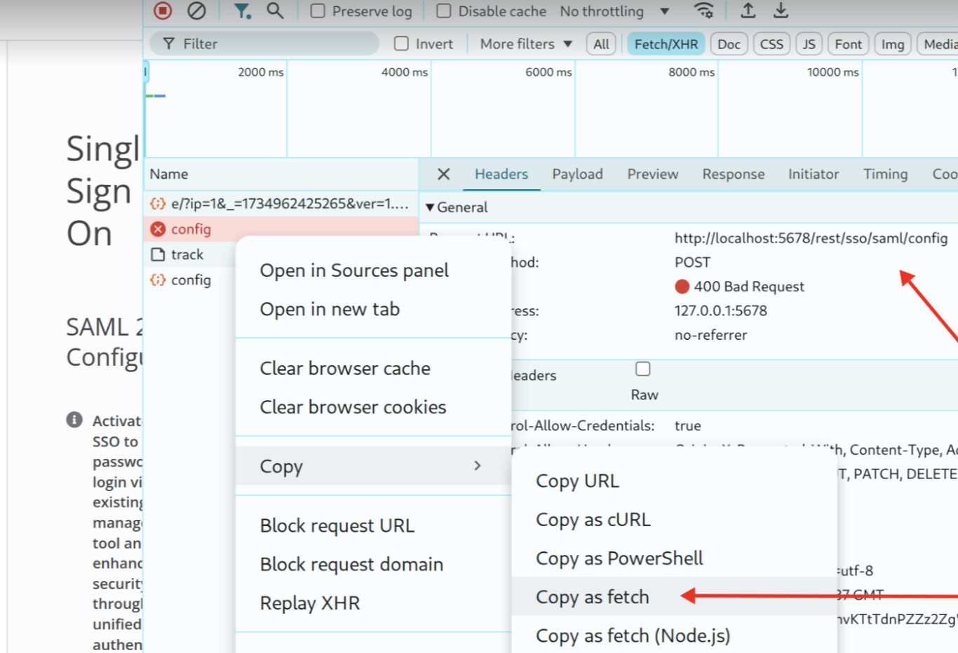

I would say for further debugging, please email our support team at [email protected] with the following things (you can refer to this thread).
(from your browser Dev Tools):
Copy as Fetch the config request (.../rest/sso/saml/config)Copy value of the body (‘preview’) → this has the stacktrace, which would be very helpfulThanks!

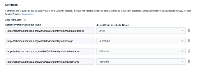

Make sure you properly configure Jumpcloud Attributes Mapping:
