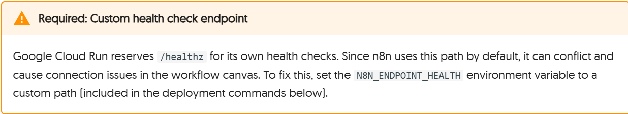

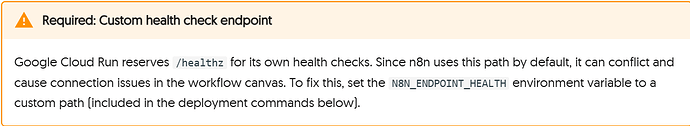

hello @Punosie
keep in mind that you should specify a custom health endpoint for GCP
Google Cloud Run | n8n Docs.
