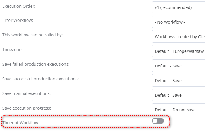

One thing to check is if timeout is defined in your workflows settings.
If this random shot resolves your issue, please like this post and mark it as a :white_check_mark: Solution.
added scripts. What you described didn’t help. Thank you for responding.
