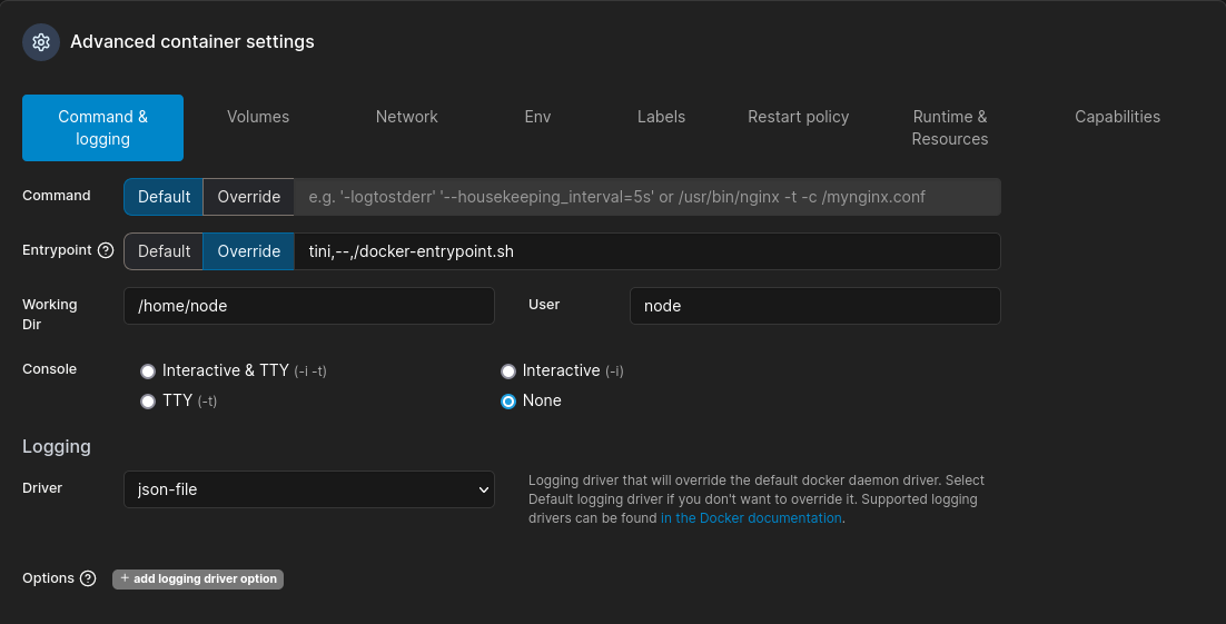

Hey @headset907,
Are you using something like Portainer? There is an extra step needed if you are when using 1.0 as it doesn’t correctly update the settings.
If you go to your containers advanced settings in the UI make sure the user is now node instead of root and the working directory is /home/node/ instead of /data

Hey @headset907,
It will be the n8n_app container, You can find the setting I shared by clicking on n8n_app then clicking Dupelicate / Edit on the top menu then scroll down to Advanced container settings and it will be there.
hey @Jon, sorry for the late response and thanks for your response unfortunately my settings are exactly the one you sent me but it’s not working.
I did redeploy with Interactive & TTY selected but it’s still not working…

Would you happen to have some complete steps for a sure build on localhost with portainer and postgres? ( I’m ready to restart everything)
thank you
Hey @headset907,
I am fairly confident in the step above as it has resolved this same issue for others if it has not worked it could be that ~/.n8n was not replaced.
We don’t have instructions specific to Portainer but if you can share a screenshot of your volumes for the n8n container I can get you the correct command to run.
