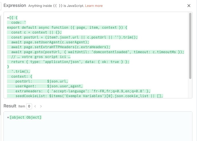

As soon as I use the {{ ... }} syntax in the jsonBody to inject data from a Set node or other nodes, I always get:
  "errorMessage": "JSON parameter needs to be valid JSON",
  "errorDetails": {},
  "n8nDetails": { /* … */ }
The generated JSON is either truncated or invalid (the seedCookieList array disappears or becomes corrupted, like “Object Object” ), even though the Set node’s output contains a valid array.

Hey @Khalagan, hope all is well.
In the middle node, the JSON starts with =, right off the bat this is an invalid JSON.
  code: `
export default async function ({ page, item, context }) {
  const c = context || {};
  const postUrl = (item?.json?.url || c.postUrl || '').trim();
  await page.setUserAgent(c.userAgent);
  await page.setExtraHTTPHeaders(c.extraHeaders);
  await page.goto(postUrl, { waitUntil: 'domcontentloaded', timeout: c.timeoutMs });
  // … votre gros script ici …
  return { type: 'application/json', data: { ok: true } };
  `.trim(),
  context: {
    postUrl:       $json.url,
    userAgent:     $json.user_agent,
    extraHeaders:  { 'accept-language': 'fr-FR,fr;q=0.9,en;q=0.8' },
    seedCookieList: $items('Exemple Variables1')[0].json.cookie_list || [],
    timeoutMs:     $json.timeoutMs || 45000,
    cutoffDays:    $json.cutoffDays || 7
}.toJsonString() }}
this probably would work.
The bottom JSON is invalid as it contains a JS object with newlines, which makes it invalid.
  "code": "export default async function ({ page, item, context }) {\n  const { postUrl, userAgent, extraHeaders, seedCookieList, timeoutMs } = context;\n  await page.setUserAgent(userAgent);\n  await page.setExtraHTTPHeaders(extraHeaders);\n  await page.goto(postUrl, { waitUntil: 'domcontentloaded', timeout: timeoutMs });\n  // … votre script ici …\n  return { type: 'application/json', data: { ok: true } };\n}",
  "context": {{
    $json.context || {
      postUrl:        $items("Exemple Variables1")[0].json.url || $json.url || "",
      userAgent:      $json.user_agent || "Mozilla/5.0 (Windows NT 10.0; Win64; x64)",
      extraHeaders:   { "accept-language": "fr-FR,fr;q=0.9,en;q=0.8" },
      seedCookieList: $items("Exemple Variables1")[0].json.cookie_list || [],
    }.toJsonString()
This would probably make it valid.
Hey Jabbsons, thanks a lot for your quick reply!
I posted that message on the forum because I had a feeling the issue was something simple, but I’m still not used to working with JavaScript inside an HTTP Request node in n8n. Honestly, I was pretty tired yesterday and out of ideas :sweat_smile:
Today, with a clearer head, I tried a different approach:
  • I moved the script and dynamic context variables into a Function node right before the HTTP Request.
  • Then I passed them properly into the request body.
Just like yesterday, I first got the classic [object Object], but this time, after applying JSON.stringify(), it magically worked :upside_down_face:
Lesson learned:
When you’re dealing with JS in a JSON (especially in a jsonBody), it’s way safer to:
  1. Pre-process everything in a Function or Code node (treat n8n like a beginner with JSON).
  2. Always double-check that what you inject is a string (when needed), not a raw object.
Thanks again for your time and help — and maybe see you around (hopefully not because of another bug :grinning_face_with_smiling_eyes:).
