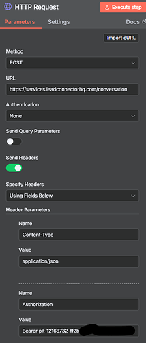

I’m getting a 422 error in n8n when trying to send an email via the GoHighLevel API. The error says:
n8n HTTP Request Node: 422 Error
I’ve followed the API documents but can’t seem to get it to work no matter what and completely stuck on what else to try.
This is how I’ve tried to set it up:
The emailFrom is the same email that I’ve tested sending emails from directly in GHL and it works fine.
Any ideas on what I’m doing wrong?
Thanks in advance

  3. Ensure the headers are exactly what the docs specify:​
  • Content-Type: application/json

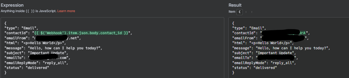

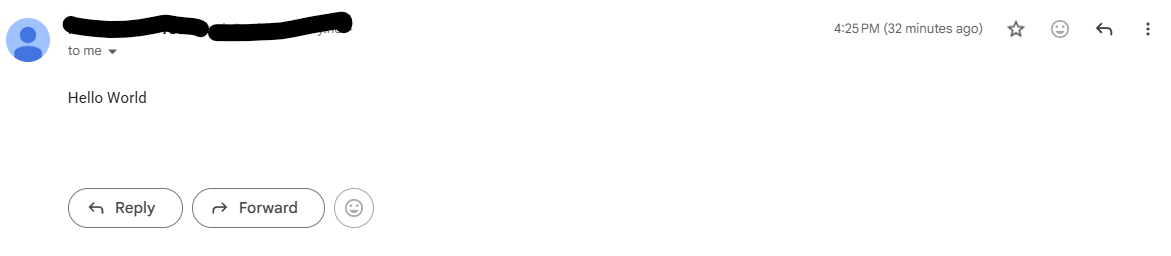

So then I copy and pasted the JSON body into n8n and got this to work:
And it works fine:

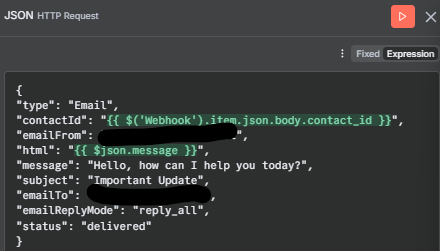

However, once I try to add variable in the “html” field: (which seems to be the body of the email not message) like so:
I get a JSON error.
Edit as I was testing it, I used a “set fields” node, for the message and that seems to have resolved the issue.
