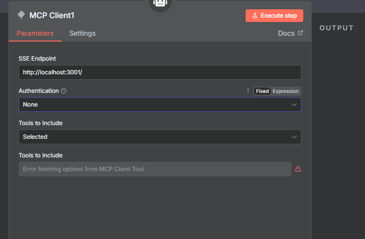

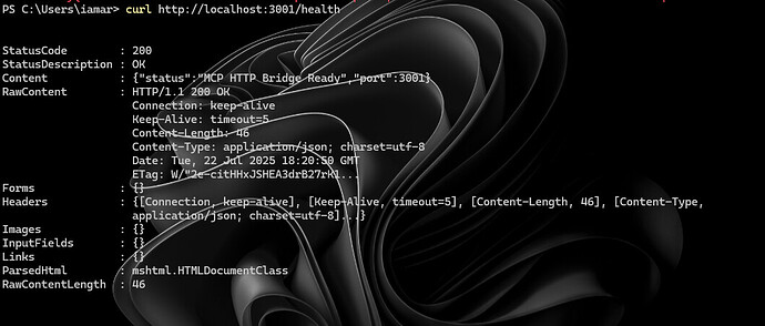

can you help me more i am stuck
can you help me
