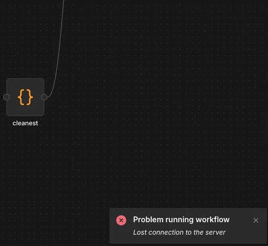

The issue with the “Lost connection to the server” and the “Invalid origin” in the log is because of the WebSocket connection issues while trying to access n8n via Cloudflare Tunnel and SafeLine WAF. n8n is utilizing WebSocket connections for real-time updates, and the proxy is blocking or failing to forward WebSocket connections properly.

5. Test WebSocket Connection
After making changes, test if WebSockets work:
Open browser DevTools (F12)
Go to Network tab
Filter by “WS” (WebSocket)
Execute a workflow
You should see a WebSocket connection to /rest/push
