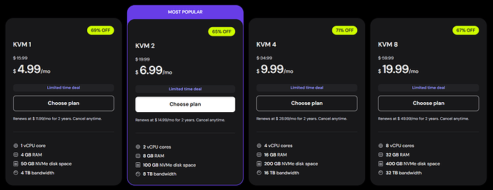

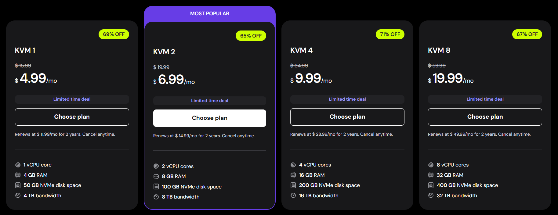

@Chris_Bradley Understood let me give you a clear outline, start with the KVM1 plan and only upgrade when the demand of the n8n usage is high and according to the use case you can also select KVM2 machine which i personally use, and also you can always downgrade from KVM2 to KVM1 and same with all other options, this will be a better take for your usecase.

Indeed that is highly case dependent, i would suggest going with the hostinger KVM setup according to your use case.
over digitalOcean?
If you prefer the shared setup then digital ocean is a better take, but i still would personally stick to Hostinger with a self hosted enterprise level plan if you ask me according to your use case of sometimes high and sometimes very low. (Also Cost Effective)

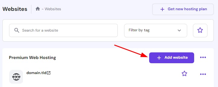

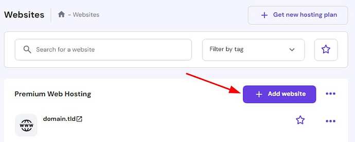

how does domain mapping work on Hostinger?
Although it is pretty much fine but consists some certain disconnection with domain sometimes, overall its all easy:
