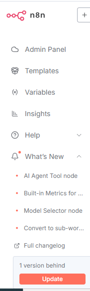

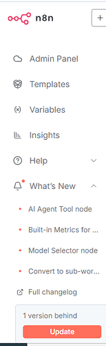

I believe the n8n in this case is in cloud. Based on
Dear @jabbson How’s everything going on. I am learning a lot from you and the stuff that you are sharing. Thank you so much for your kind efforts.
Recently n8n update some changes into cloud one too, and suggest us to update the version of n8n.
So, I am suggesting that one.
By the way, how it feel to sit on the top of the lead board ??
Thank you so much for your kind efforts again…
Ah, I didn’t know you have to update the cloud version too, thought it happens automagically. See, I am learning something too :slight_smile:
That’s funny indeed @jabbson
see this
