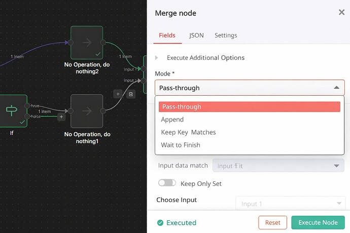

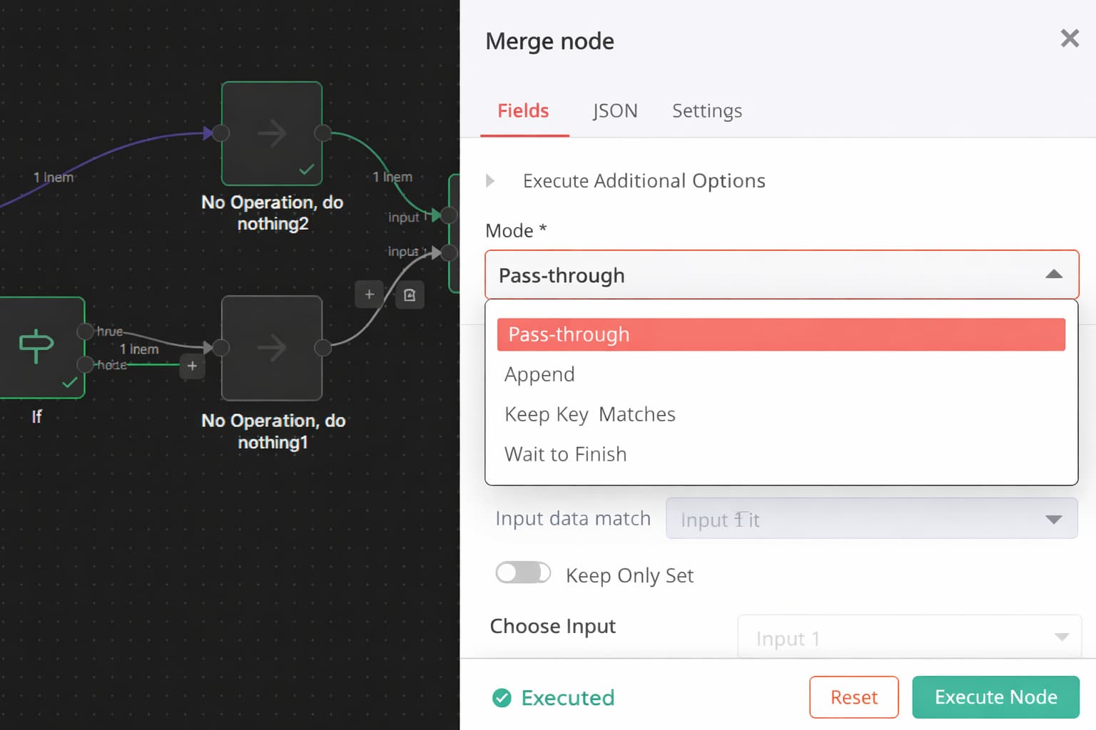

change switch to pass trough
:smiling_face_with_tear::face_holding_back_tears::face_holding_back_tears::face_holding_back_tears::face_holding_back_tears: what switch, im sorry
please explain me why the merge node gives output here and not on next one
@Milyn_Dsilva_CC
Everything is fine, we will get there.
Go to the node merge parameters and change it to pass through

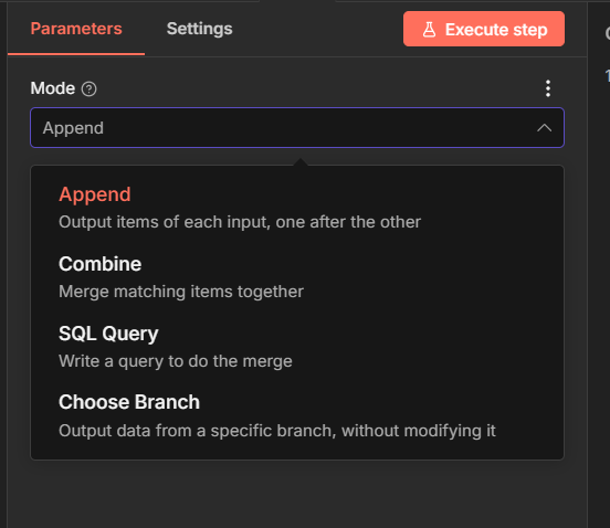

the version that im using does not have this, also both screenshots are append and not pass-through mode which i shared

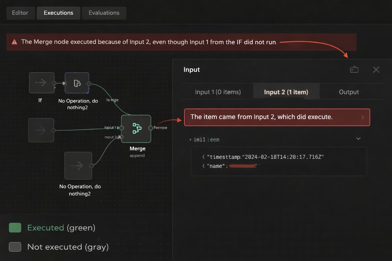

I got a bit confused with the thread too, but I think I understand it now. The Merge node doesn’t require both inputs to have items, but it does require both branches to execute. One input can have 0 items and the Merge will still run, but if a branch never executes, the Merge won’t produce output.
Could you please confirm in the execution view whether both Input 1 and Input 2 actually executed (turned green)? That will help confirm what is happening in this case.

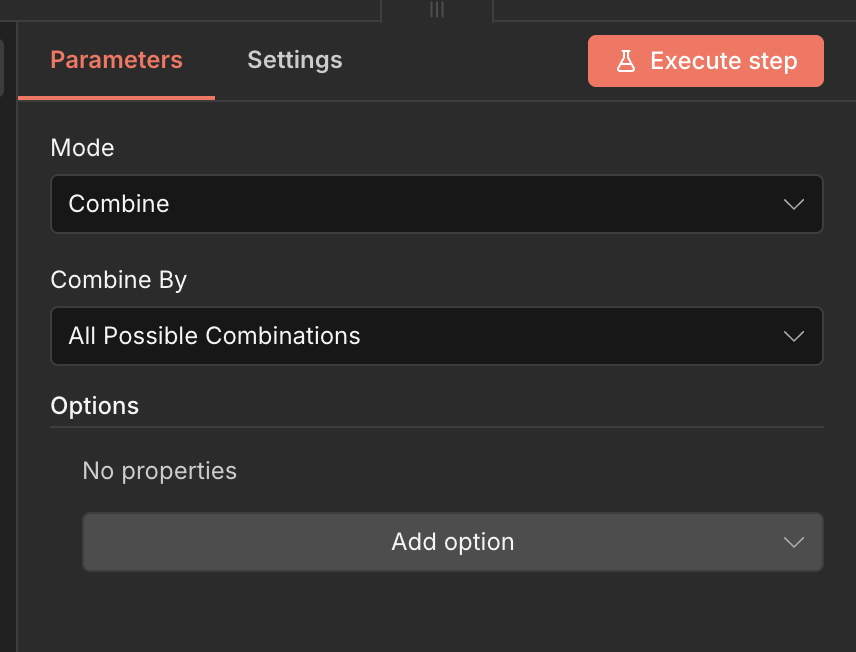

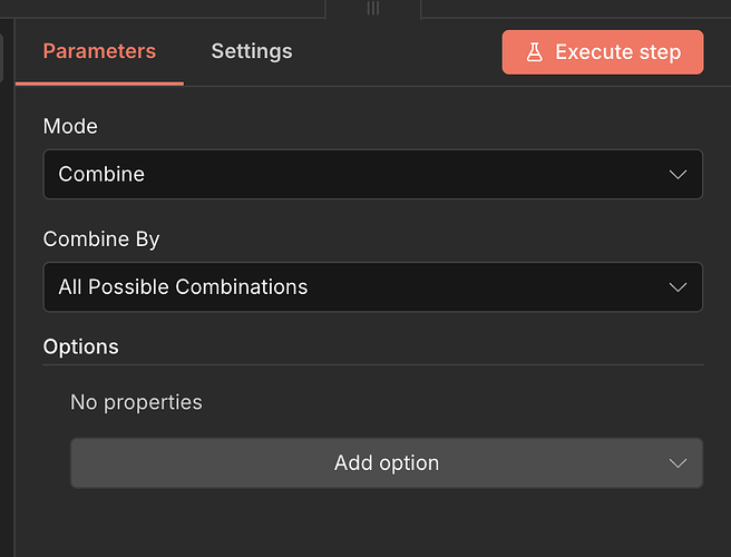

I agree with @Anshul_Namdev If the branch connected in the second input of the merge node doesnt get executed then the merge node is going to output the value in input 1. The merge node can be confusing and it has multiple functionalities accross different usecases. I have created a small workflow for you to show the functionality of the merge node clearly.
In your usecase if you want it to wait for both outputs and assuming both branches are getting executed you can use the “combine“ option to combine the inputs of the 2 branches.
