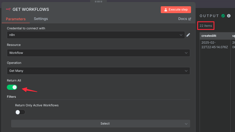

Thanks for the response. I’m seeing the total number in “Overview”; not including the folders. Here’s another example:
Can you check the 4 workflow missing on API is there any special about them?
Maybe share from others. But you using docker it’s more likely on community plan or enterprise plan.

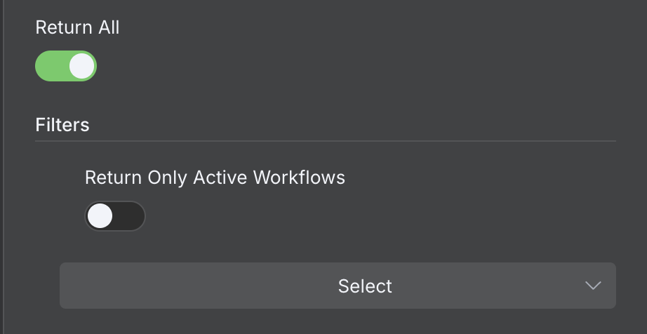

Great question; turns out the workflows that weren’t getting captured were the ones that I had as Active… I turned them off temporarily and they all pulled in and backed up correctly. I turned them back on and ran it again, and they were missing again..
Why would that be? Is that how this node is developed? I guess the work around would be to duplicate this node and pull inactive workflows in one, and active workflows in the other..
I think I know the difference
In your case : This will only return non active workflows
If you want all. You need to remove the filter option.
I guess it will put a false in the filter.
So remove it will be no filter
Sorry didn’t catch that point before.
