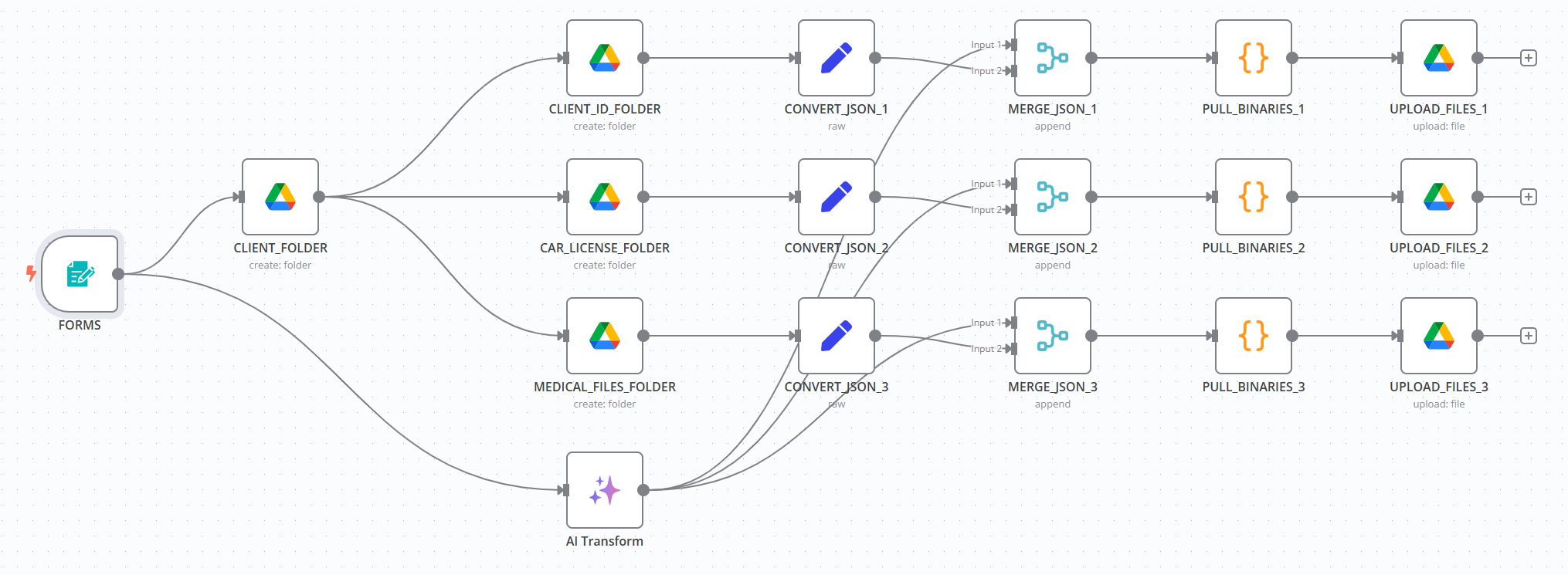

i had a working workflow on n8n cloud

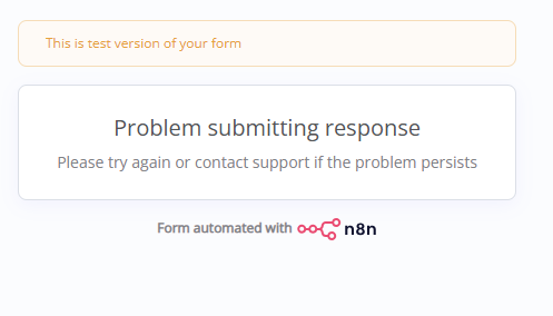

i then tried to import it to my deployed n8n pod on lke cluster. everything looks ok until i try to submit the n8n form. it then say " Problem submitting response
Please try again or contact support if the problem persists" and nothing happens.

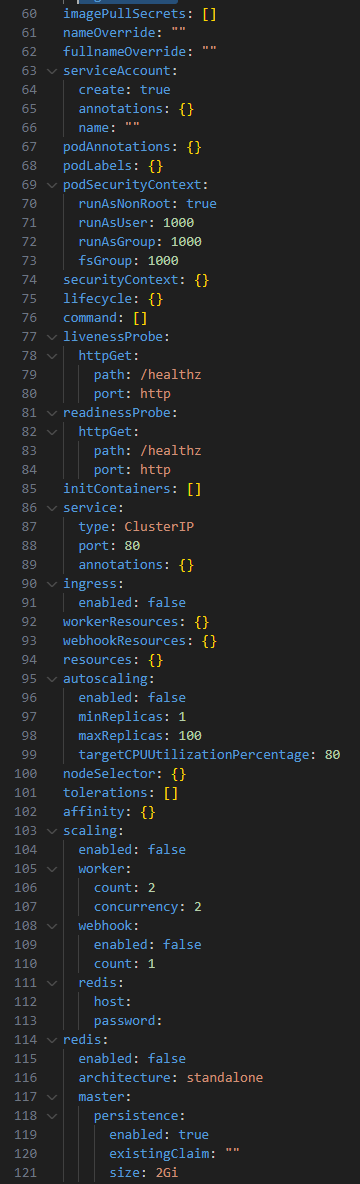

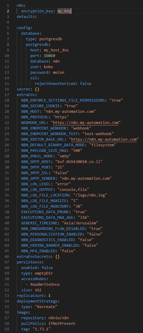

I’m adding my helm config

it appears my issue was with the ingress payload.
i had to add to the ingress annotations
nginx.ingress.kubernetes.io/proxy-body-size: 1000m”
