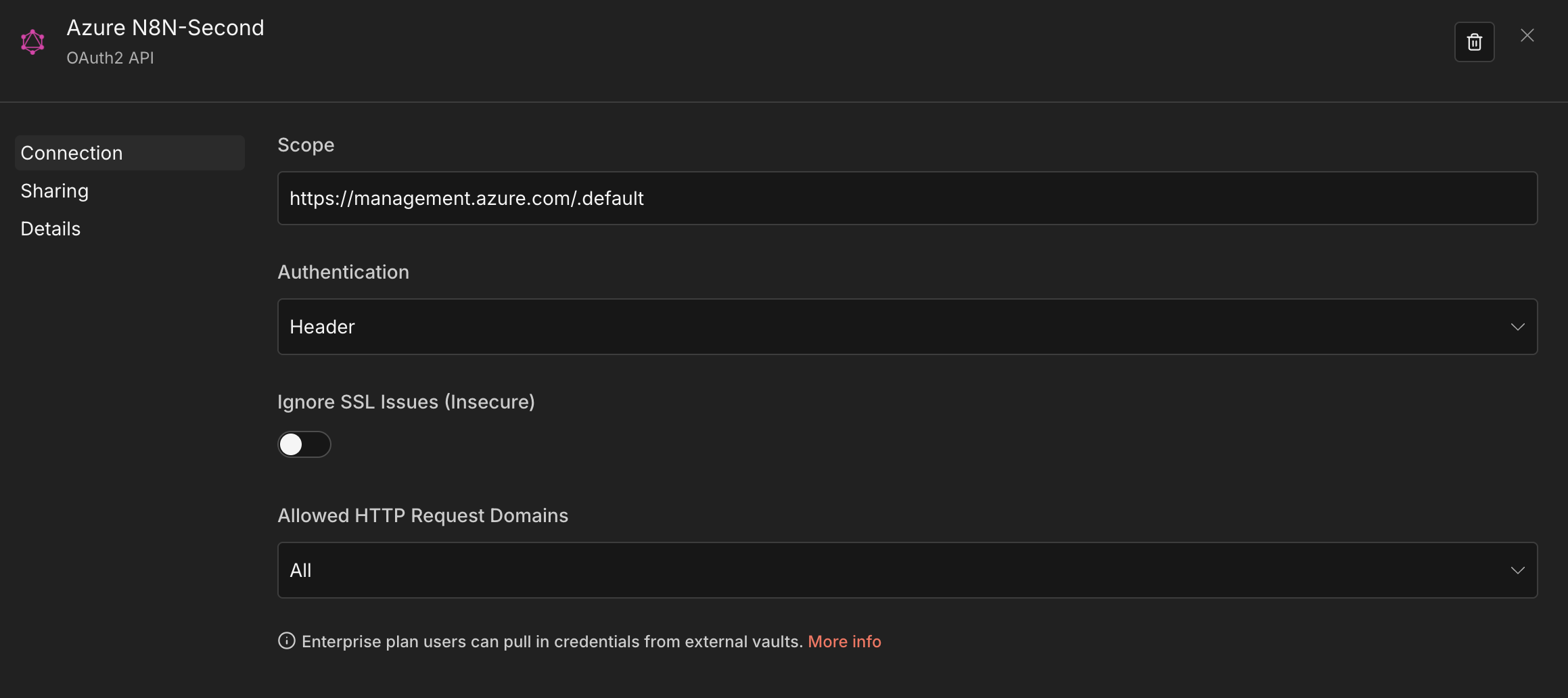

How is you Oauth2 credentials set up? You have the option to send it in body and header:
Most API’s will use header
this api seems to want body per the documentation but when testing in postman it accepts it either way. I’ve tried it both through here. I’ve also check the developer console logs and it never passes the Bearer token in the header in the POST request.
Alright, is your grant type set as client credential?
Yes its set as client credential
