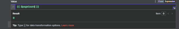

In the update query params, I can see the offset not being updated, because we are multiplying $pageCount with 50, which is still staying zero for some reason. Here is the screenshot. When i access the pageCount variable it is 0.
You see 0 because at the time of you looking at it, the loop is not iterating, which means the next value for this expression is going to be 0. After the first iteration the count becomes 1, which will make the expression to be 150, then 250 and so on…
