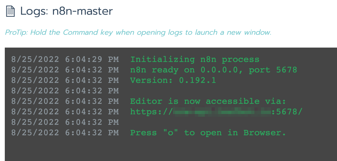

expose port is working normal but -p 443:443 is not working because inside container not listen port 443
You could run use -p 443:5678 instead (as in docker run -it --rm -p 443:5678 --name n8n n8nio/n8n:0.192.1). This way, the n8n container would use port 5678 internally, but you can still access n8n via port 443 (http://localhost:443/) of your host.
If use default port (5678) is working
and redirect url will be https://abcd.com:5678
but problem is oauth redirect when I try to connect with google service they redirect to https://abcd.com:5678/oauth it will not found URL
Perfect, so that’s the first step done. You can overwrite the OAuth redirect URL by setting the WEBHOOK_URL environment variable to the URL your n8n instance is publicly available under.
