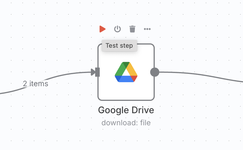

I typically pin data and then run the nodes 1 by 1 by clicking the run on that node like this
So if my data in pinned in node before, it doesn’t seem to trigger a whole run again which is nice.
@DomBe Hope this helps

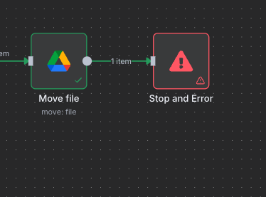

Hey everyone,
I ran into the same issue where all my nodes were executing twice. I found a workaround that’s not exactly elegant, but it works. I added a “Stop and Error” node at the end of the workflow to force it to stop after running once.
It’s definitely not the cleanest solution, but since my workflow runs automatically every day, this has been the most reliable fix so far.
Hope this helps someone!
