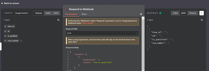

I’m triggering workflow with webhook which requires response at the end of automation.
Even though I have mentioned JSON and typed JSON in the Response Body, it is ignoring it and sending result of previous node as webhook response.
You can see screenshot where is Webhook response is output of previous node (Google Sheets) & not webhook.
(I’m not sure how safe it is to share workflow here as it has API keys, but can anyone please troubleshoot why I can’t send this JSON as webhook response?

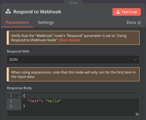

The Respond to Webhook node is designed to respond to the webhook. By design, it doesn’t actually show you the output in the panel. I know this can be a bit misleading, but the rationale is that the response it sends is normally not useful for the rest of the workflow…
I’ve used Postman to test the general behavior and it’s receiving my JSON response just fine:
Here my test setup:
Can you share a bit more about how you’re testing it?
Also, which version are you on?
