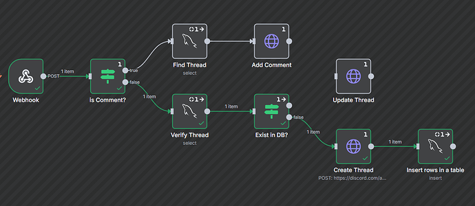

Inside the workflow:
  • I check what type of event it is (comment, creation, etc).
  • I query my MySQL database to check if that task already exists.
  • If it doesn’t, I create a thread on Discord and insert the task info into the database.

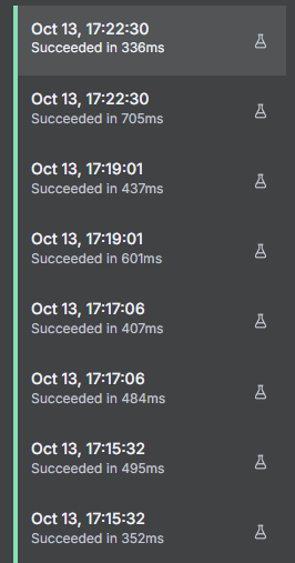

The problem:
Even though the workflow shows only 1 item in the output of every node, the workflow:
  • Creates 2 identical Discord threads, and
  • Inserts 2 identical rows in MySQL (only the thread_id differs).
Things I’ve already checked:
  • Webhook is set to Respond: Immediately.
  • No duplicated connections or extra branches in the workflow.
  • Plane is sending only one webhook (confirmed in logs).
  • No retry or split nodes configured.
Yet it seems like n8n is somehow executing the same workflow twice in parallel, even though only one item shows in the run data.
Has anyone experienced this behavior before? Any ideas what might cause this kind of silent duplication?

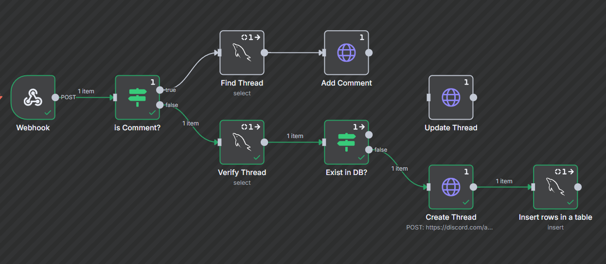

No, there are only 1 workflow working as you can see in the image
Nothing works in parallel, that’s the issue, everything indicates working fine, but in the end, in my MySQL and Discord it’s duplicated.
Go to executions. Does it show it triggered twice close to each other?
Yes, looks like it’s executing 2 times close each other.
Is there anything i can do to avoid it? I’ve already change to execute ONCE and the problem persist.
i solved the problem.
The duplicate comes from Plane Webhook, it’s not inside N8N, i have to implemente new validations to deal with this duplication. Everything is working fine now!
