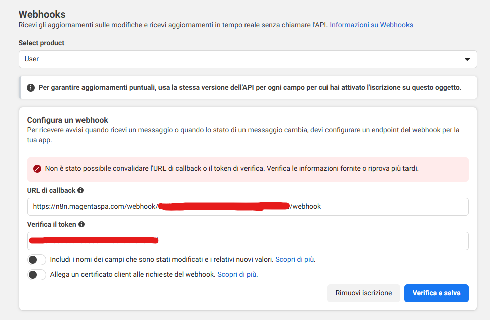

I think the problem is on meta > app > webhooks
i cant verify the webhook, where can i find the verify token? I red many forums: some tell you to add the WEEBHOOK_TUNNEL_VERIFY_TOKEN=MYTOKEN in docker compose and use this token to verify the webhooks. others tell you to use the app token from the developers menu. In both case i cant verify my url.

Hi, i found out that the problem was that i was trying to verify the webhook with a user token. I had to select Page from the menu and then subscribe the leadgen in the option that appear when you select Page.
The verify token was a string decleared in docker compose. This often get confused with the access token
