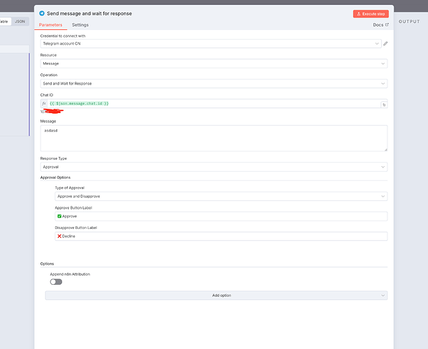

I have a few workflows that use Telegram to send info and ask for confirmation.
IT used to work perfectly. But now suffenly I get {“error”:“Invalid token”} as a response when trying to approve, devline or complete a webform in n8n
What can the cause be?
My credentials and workflows are reading correctly, and I can receive normal Telegram messages via triggers
But a simple Workflow like this is not working anymore
I tried adding a new Bot nd new credentials
I have set
Webhook URLs

N8N version: 1.106.3
Self Hosted
Any help will be appreciated
EDIT: When I tried it on an older version, it worked. Could it be a bug in 1.106.3?
n8n version: 1.106.3
Database (default: SQLite): Testes both SQLite & PostgreSQL
Running n8n via (Docker, npm, n8n cloud, desktop app):npm
Operating system: Debain
