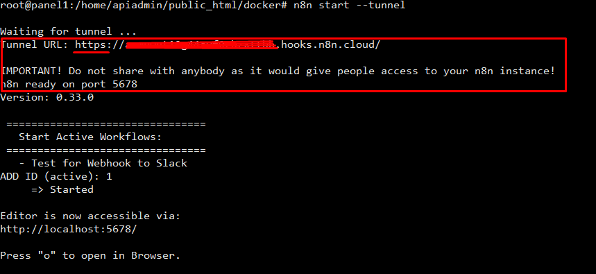

I have installed n8n on my server and I was trying to use a webhooks node with my website contact form. At first, I was unable to pass the data through webhook then I have gone through the documentation and found something called Start n8n with Tunnel. Later, I used the command to start the n8n with tunnel and tried to pass the Details of the form to slack and it was successful. And I am able to trigger the webhook from my contact form and the complete workflow is working as I desire. I am just concern about the warning given for using the tunnel command. It is said to use tunnel only for the testing purpose, not for the production. I have tried to figure out how to get my workflow executed without using the tunnel and I was going through some of the tutorial videos in youtube and I find in a video that the URL is " https://jan.users.n8n.cloud " and the tutorial is explained on this domain which is having SSL installed. I want to set up my subdomain with n8n same as it is set up in " https://jan.users.n8n.cloud ". And moreover, I don’t have any idea what is docker and how to setup.
Tunnel URL is Secure with SSL I want my subdomain to have this tunnel kind of setup.
