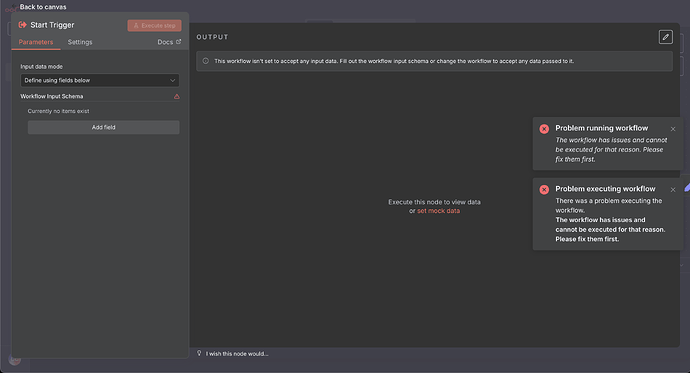

N8N Start Trigger parameters" "inputDataMode" doesn't load when uploading json
I’m trying to build a master orchestrator workflow that passes Content_ID, pipeline_mode, and other values into downstream workflows (V6a–V6f) using Execute Workflow nodes.
The Start Trigger is set to “Define using fields below” and has a proper input schema in the JSON — but it never shows up in the UI and gives me this error:
“This workflow isn’t set to accept any input data”
No matter what I try, I keep getting:
  • “Problem running workflow”
  • “Workflow has issues and cannot be executed”
I even copied the working setup from V6a exactly. The JSON is valid and loads fine, but the schema doesn’t register.
Error message

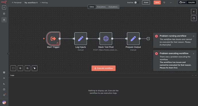

The workflow has issues and cannot be executed for that reason.

To use “Define using JSON example” correctly, change the Input Data Mode in your Start Trigger to “Define using JSON example.” Copy and paste the test JSON that reflects the structure of the data you’ll upload. Save the workflow. Now when you upload a similar JSON, the fields should appear as editable parameters.
I see, so for the start trigger node, it should always have a predefined json structure of the input fields I am looking to add? Do I need to put as many fields in the start trigger or just a couple? Also curious about the Accept All Data option vs the predefined json.
Thanks for the help, that worked!
