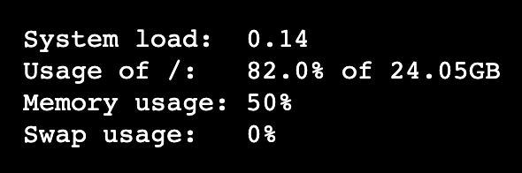

is this normal? (80%+)
Could you provide some more details on your n8n setup and workflow load?
It could be normal, if there are lots of active workflows with lots of data thruput.

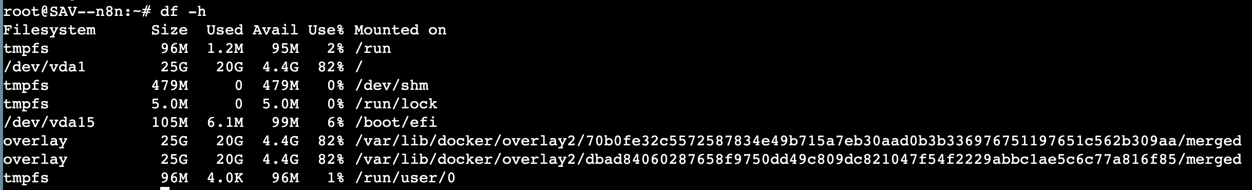

I did df -h in the Droplet console, and got these details:

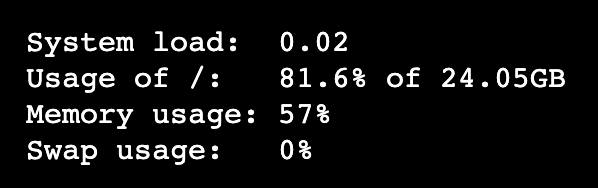

I have another similar n8n instance in Digital Ocean, with the same work-load (~60 workflows), and the usage is way lower:
Are you using SQLite? And are you storing lots of successful executions? If so, your database probably keeps growing, and you may want to look into data pruning.
Using Docker Compose, not sure which database type it is
And it’s still the same even after removing all the executions

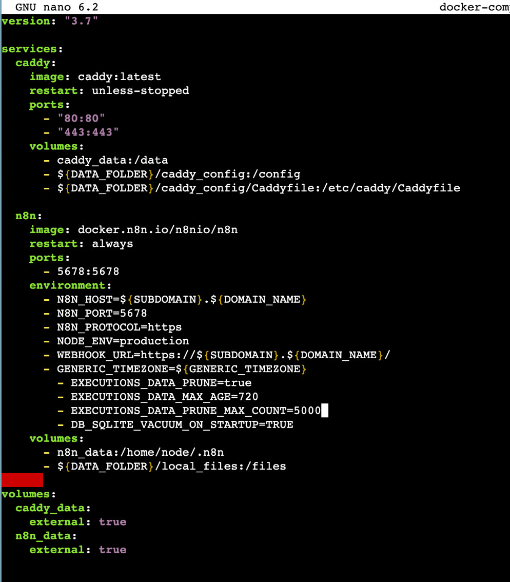

Applied the same settings
But I still don’t see the percentage dropping
And the n8n instance currently only has ~150 saved executions
Two ideas:
  1. Please validate your YAML - it’s very sensitive to indentation, and I noticed the pruning options are looking different from the rest.
  2. Did you restart your instance? Any errors in the logs?
