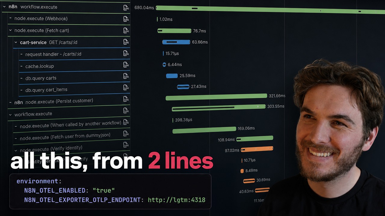

Hi @StuartJohnson and @muxxi
Just wanted to say thanks again for starting this work on instrumenting n8n with OpenTelemetry for 1.x.x — it was a great foundation.

Just wanted to let this thread know that we started rolling otel tracing out officially :grinning_face_with_smiling_eyes:
Starting with workflow tracing, with more following soon behind it.
