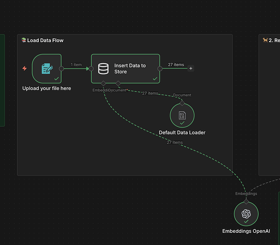

When I upload a new file and run the insert flow, the OpenAI API usage stays flat. It looks like the Embeddings OpenAI node is not actually calling the embeddings API during insert.
What I observe:
• The Data Loader runs successfully
• The Insert Data to Store node runs successfully
• The visible output of the insert flow is plain text chunks/documents, not embedding vectors
• The retriever/query side is still able to answer from the vector store

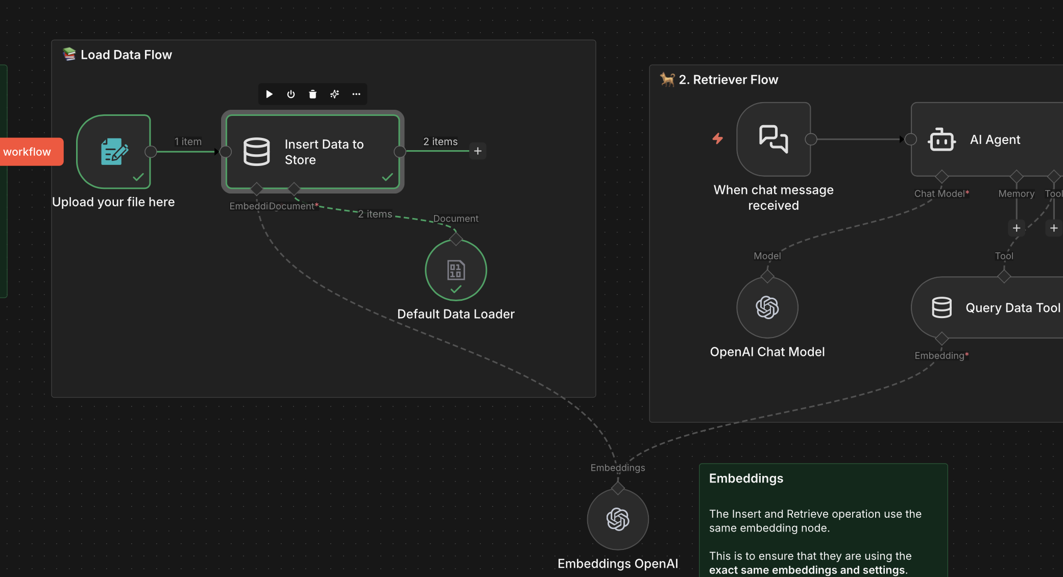

Update:
I tried it in n8n cloud and its working:
It is not working on my self-hosted instance. Its not calling the Embeddings OpenAI.

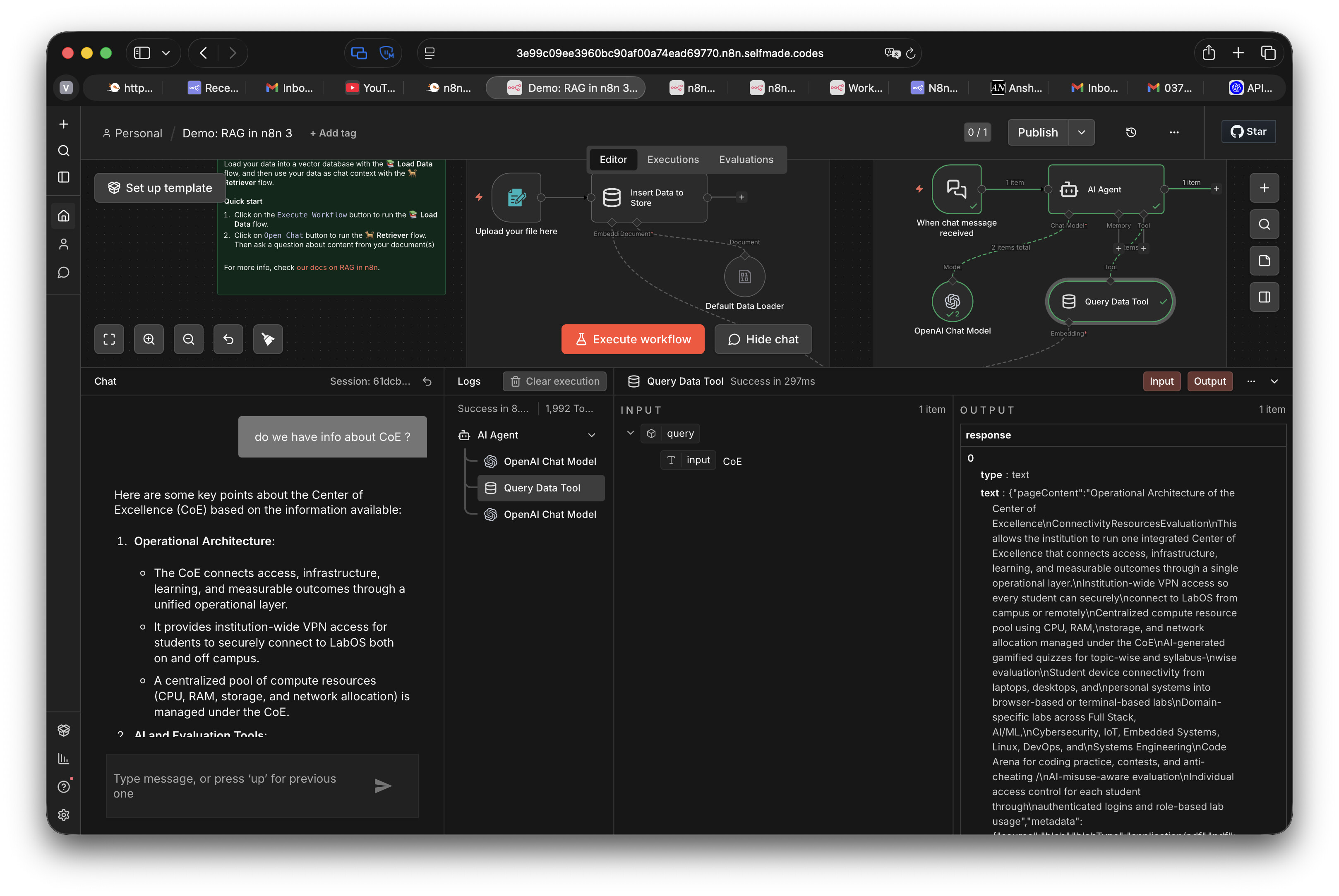

Have you tested the chat message? Does it work? If it does with the document you have chunked, then there should be a lag or internal execution as sometimes the workflow UI sometimes does not catch up, although you can try this same with similar database like Pinecone if that works then nothing to worry about as sometimes the executions may happen internally in some cases although this should not but if it works then that’s it.
Chat seems to work… It is able to respond with the inserted documents. I havent tried with Pinecone yet, will do that and update.

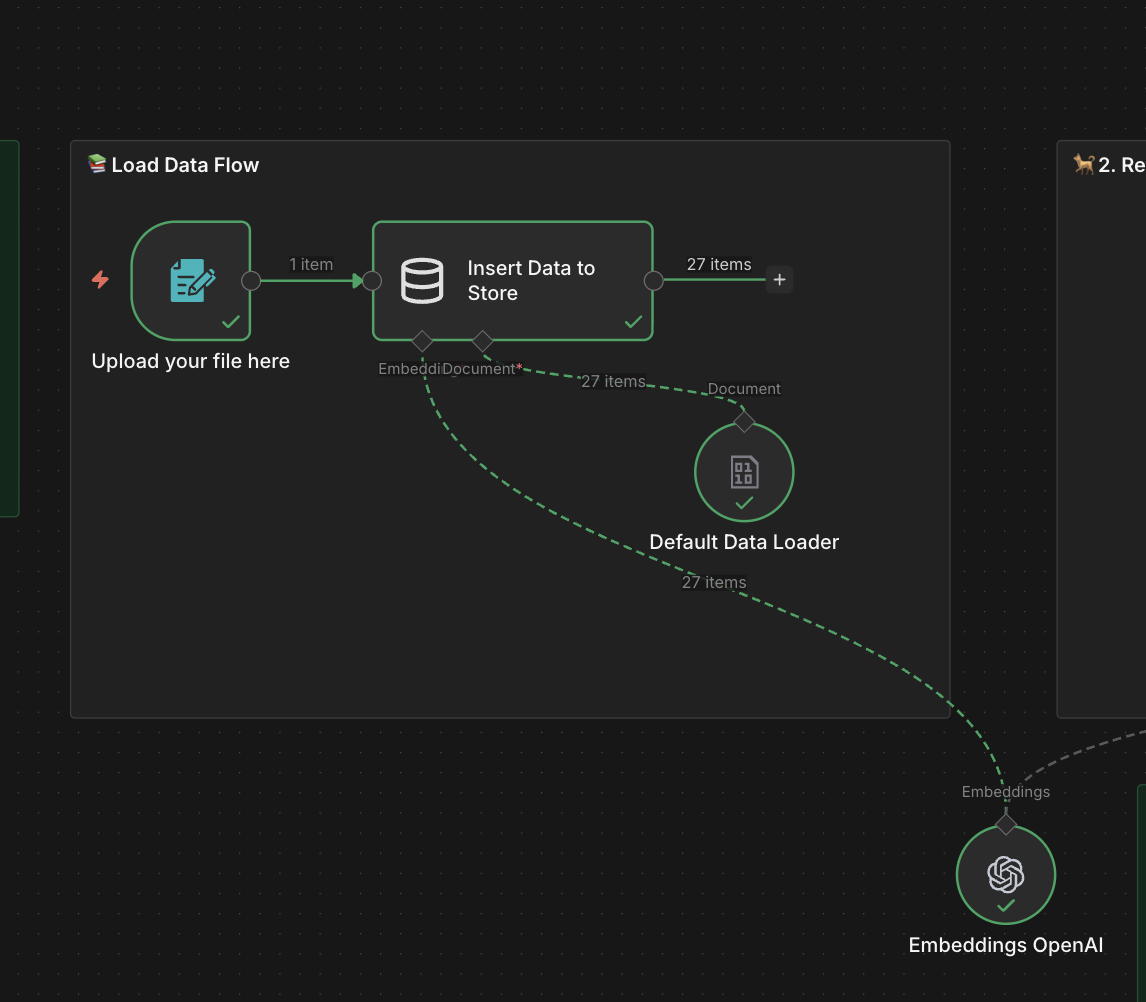

Yes, the chat is using OpenAI and it is able to respond. We are using OpenAI for lot of other things and it all seems to work. Just that Embeddings node is not getting highlighted when its supposed to turn green!
In the last screenshot I posted, the OpenAI Chat Model is turning green! Just embeddings not when inserting documents - as its supposed to turn green - I saw it before, but this current behaviour is making me question.

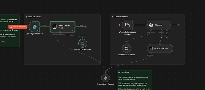

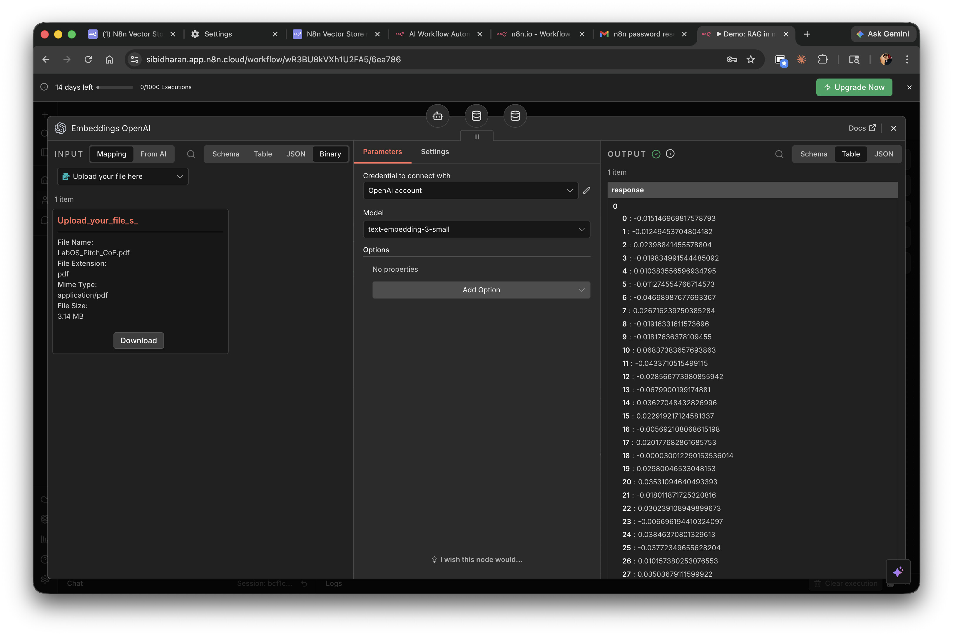

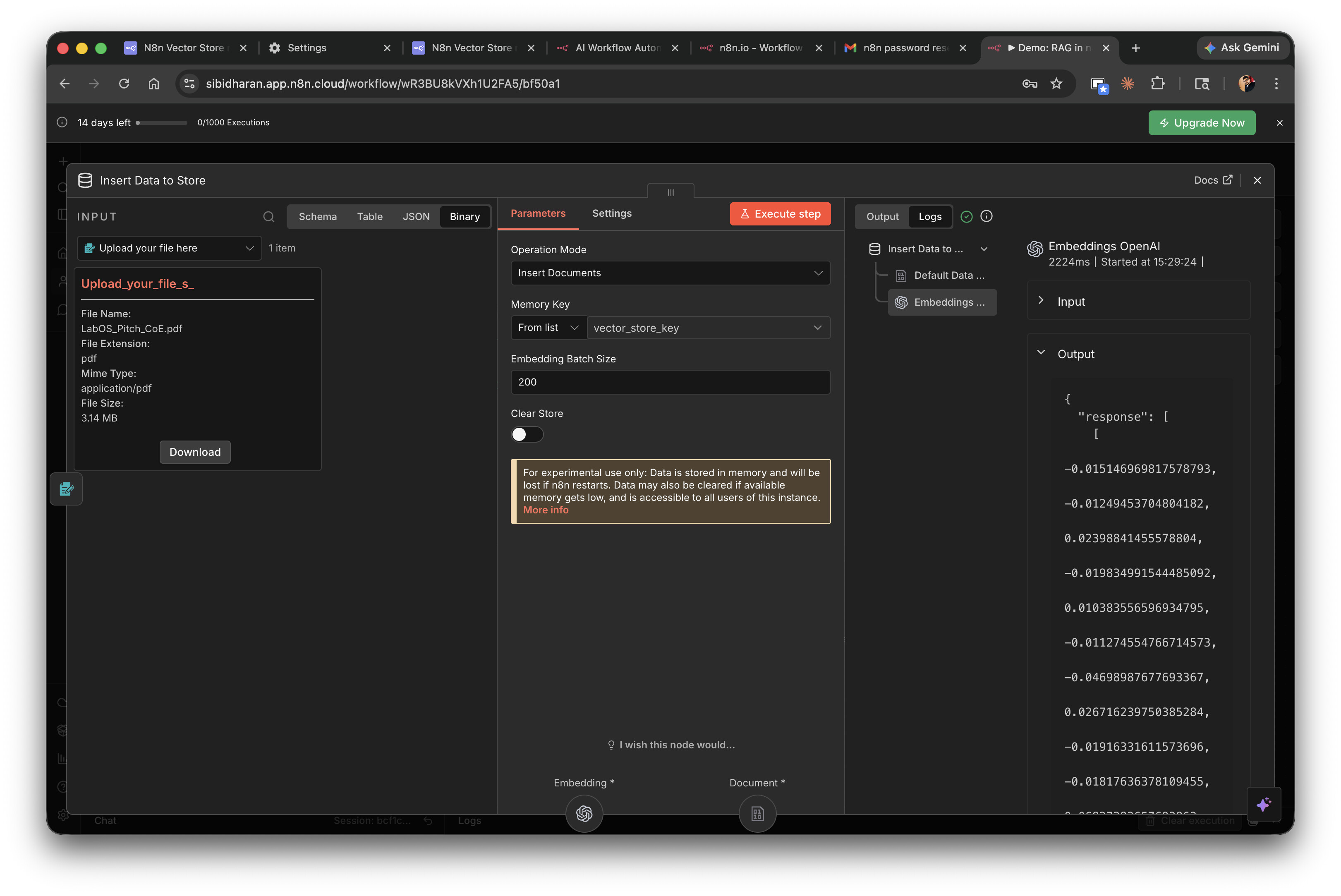

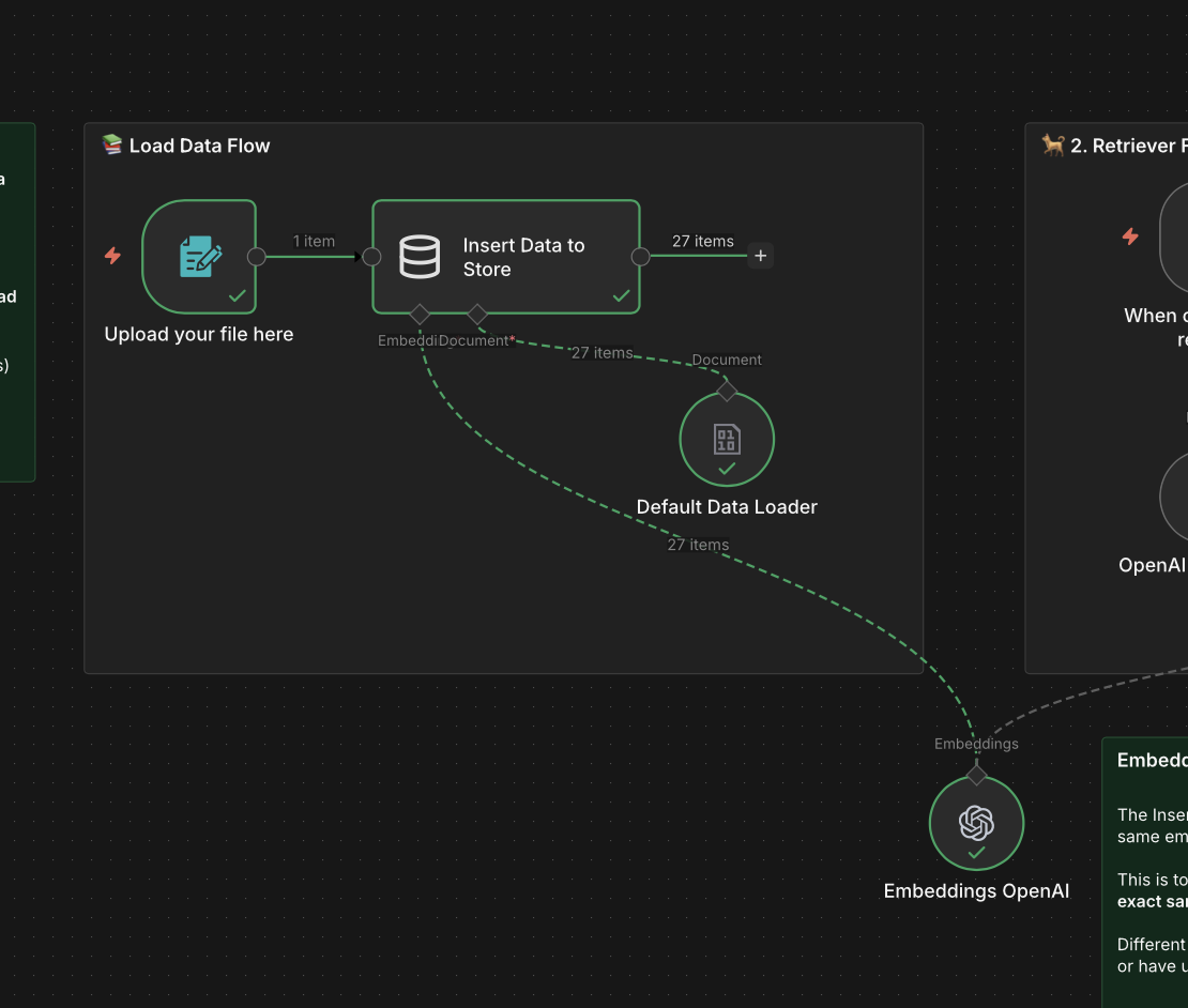

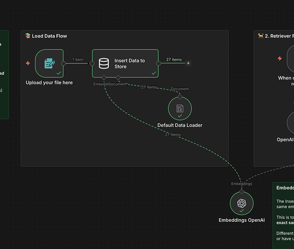

I see the Embeddings Node being called with same API key in n8n cloud with same app version: 2.12.3 - I am running the same 2.12.3 in my self hosted instance. Please see the difference:
n8n Cloud:
Then the embeddings node turned green and I can see the numerical embeddings:
Logs:

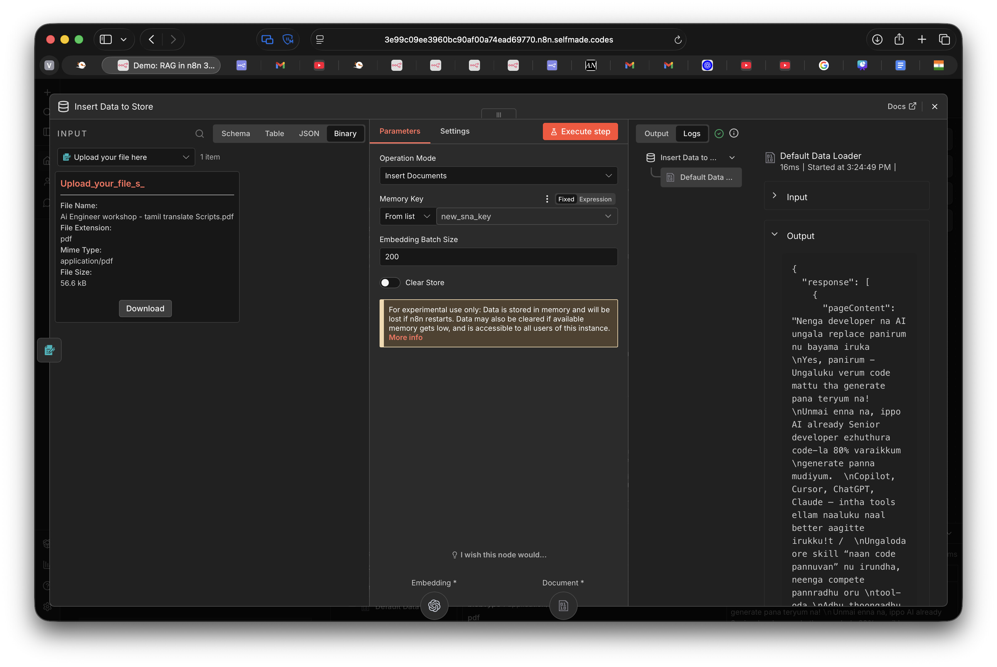

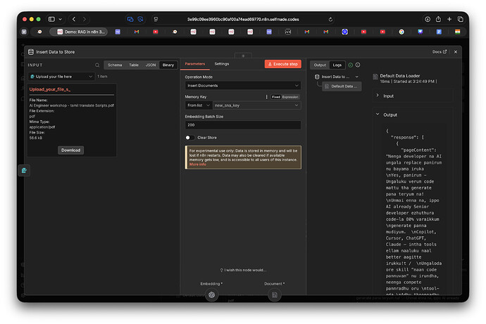

In my Self-hosted Instance:
Logs:
The Embeddings sub-node was never called, nor I could see the numerical embeddings in the logs.
