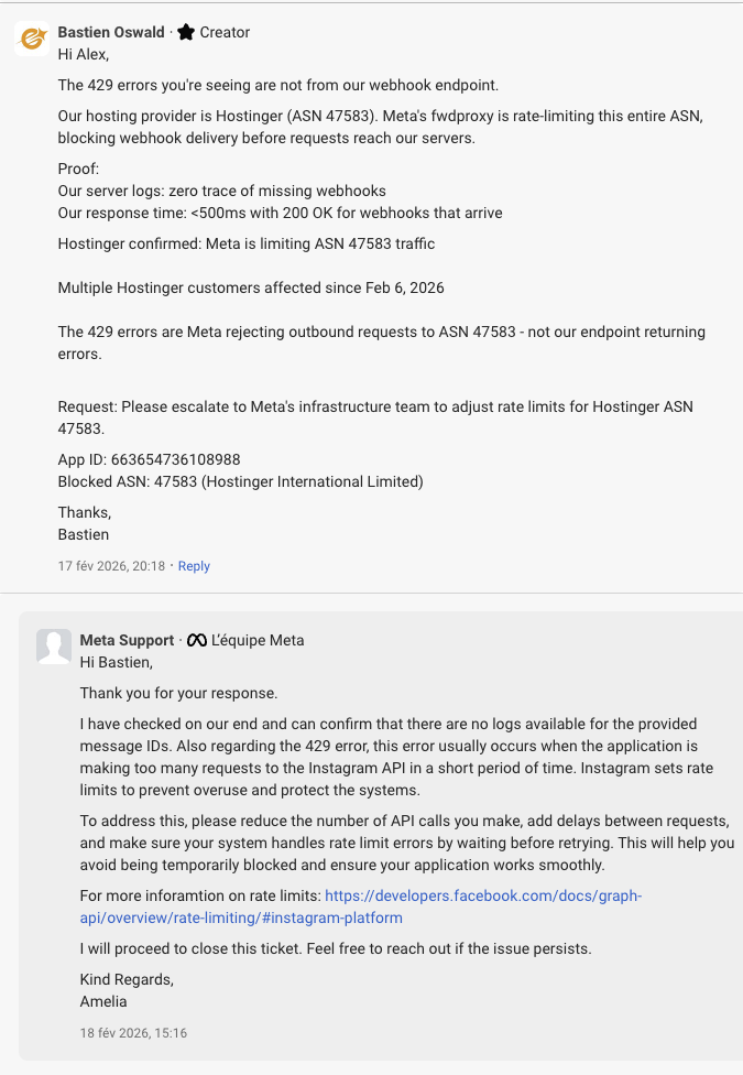

Response from meta :joy:

I’ve already resolved the issue. In short, yes—it has been confirmed that this is a Hostinger-related problem. Here’s a temporary, low-cost, and quick workaround you can use: Solución: Webhooks de Meta (WhatsApp) con Timeout o Retraso en Hostinger (Rate Limiting ASN 47583) - Azul School

They’ve already confirmed it, but they haven’t dared to release an official statement. In the link I left above in the comments, I posted a screenshot of the email where it’s confirmed. But it’s in Spanish.
