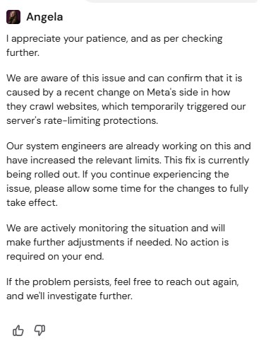

I saw Angela from Hostinger support said a fix was being rolled out. Did it actually fix the problem on your end?

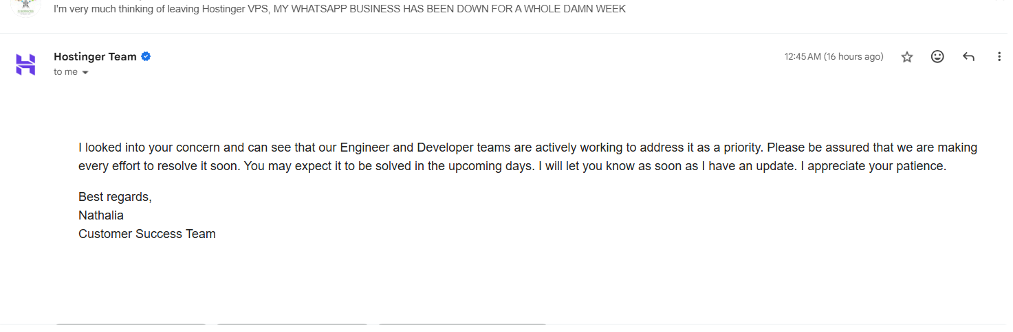

No, they have not fixed the issue. And they cannot confirm when it will be fixed and they are relying on you to check regularly to see if the problem is fixed.
I have very little faith in them currently, because a week has passed and still no progress.
