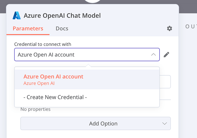

What options does that node have for the credentials?

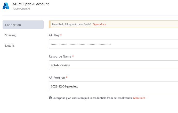

And this are the values:
Here i would expect another field to set the URL

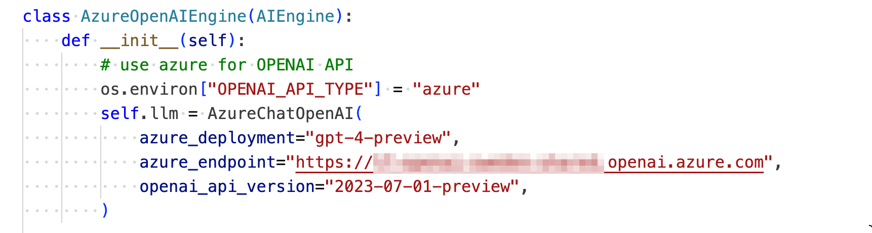

When i use this endpoint in Langchain it looks like this:
You can clearly see that i provide a custom endpoint URL.
Hey @MehrCurry,
We should probably make it clearer it in the docs, The resource name is the instance name so in the credential you would put the bit that is blurred out in your python.
Hi Jon, thanks for coming back quickly. But to be honest i do not catch what you mean.
But with some help from ChatGPT i figured out that only the first part of the endpoint url (that one that is blured out) should go into the Resource Name. And that did work for me. Thanks for that.
So it seems that the azure_deployment from langchain is not needed in N8N?
Not working for me guys. I alwata get the resource not found error, even though I´m using the right resource name
