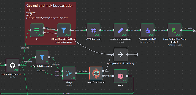

I tried to share the workflow in my original post but the n8n page froze, proposing me to refresh the page.
This time, I can post the workflow, which processes up to ~400 files, per batch of 25 to 40.

Hi, I don’t think I will make a big difference but you can try. If it’s memory related it will help, can you see how many times the loop is performed? (How many API calls are done?
The workflow fetches around 40 subfolders, so I guess 40 calls.
I’ve set the batch at 2 and wait time at 0.5s.
