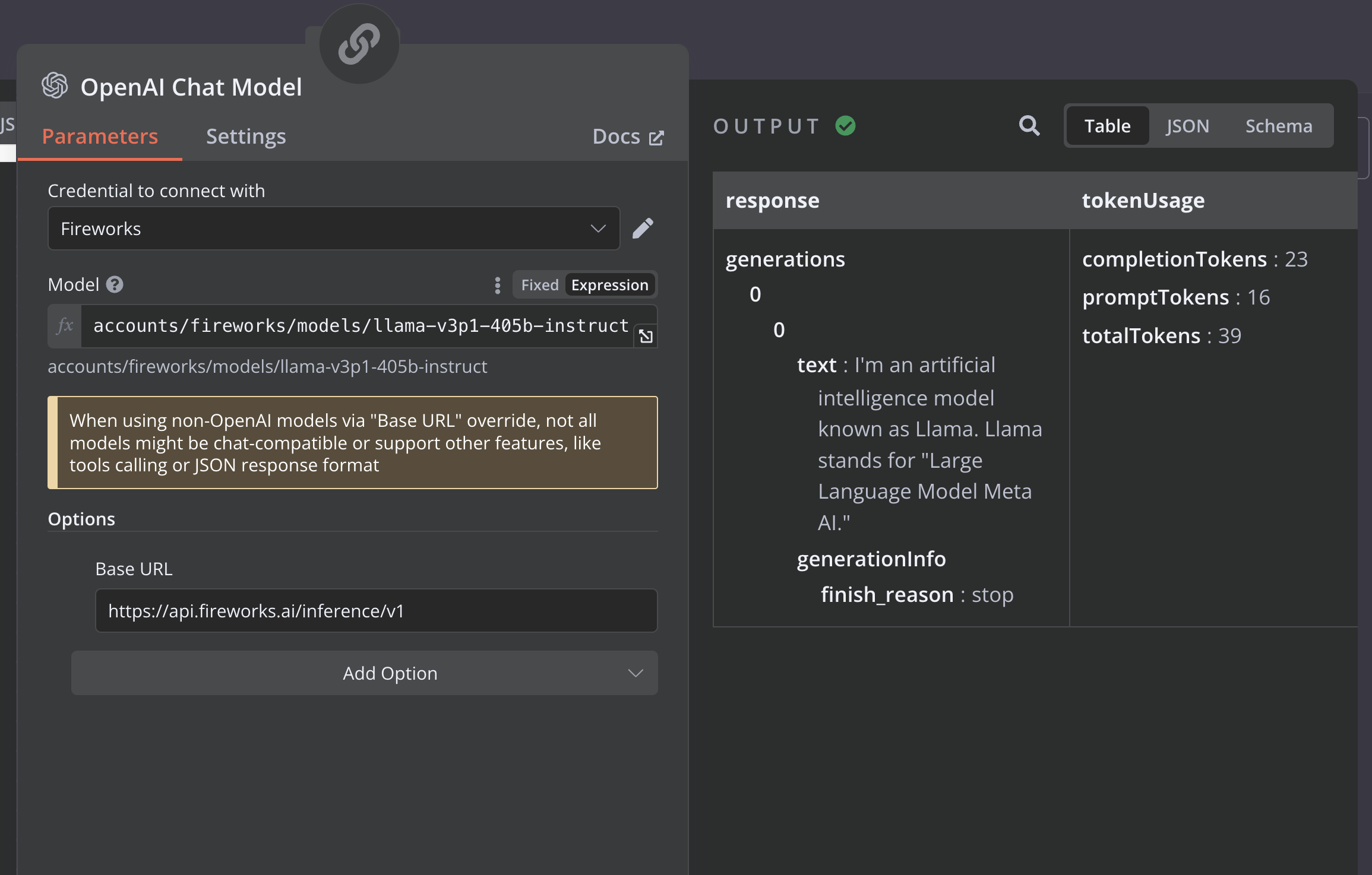

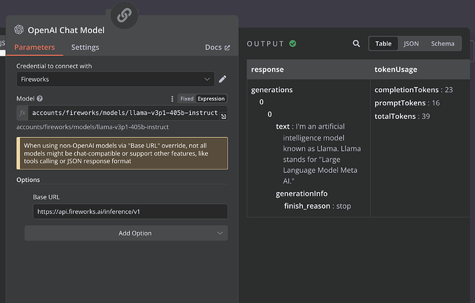

Hi @h8h,
while we don’t have a native Fireworks.ai node, they are using OpenAI API interface so you can just use OpenAI Chat Node and change the baseURL to https://api.fireworks.ai/inference/v1. I just tried, and was able to chat with llama-v3p1-405b-instruct:
Here’s a very simple workflow that demonstrates it:
I hope that helps!
