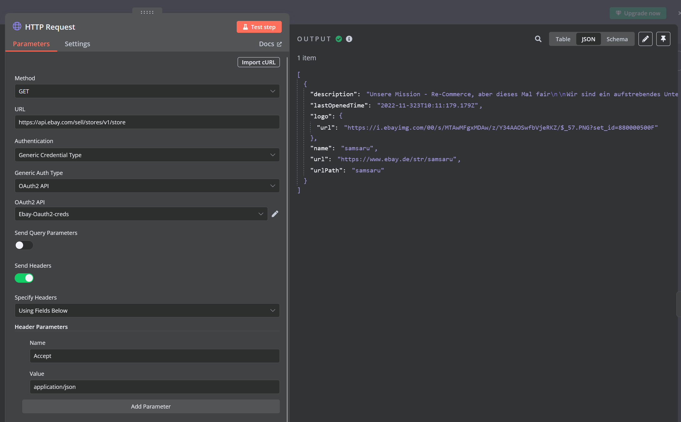

So what I finally did (in my case I needed both APIs) is to build a first workflow that uses the new API - (in my case to create an inventory task) and at the end a node that calls a webhook of a second N8N workflow. The access token that I need for further authentication against the old school API is then automatically sent in the request header trriggert by the first workflow. Seems hacky…seems kind of unsave, but it works…
Get Node that calls my own 2nd Workflow with oath creds:
And the 2nd Workflow that use the old soap API with the “handed over” Access Token to reduce the item quanitity of a specific Ebay Article in our inventory:
For thoose who only want to use a newer Ebay REST API: Node should look like this:

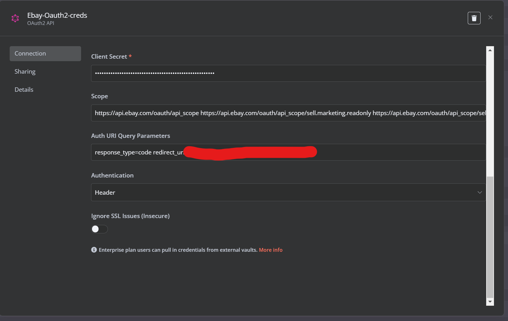

…and the credentials config like this:
