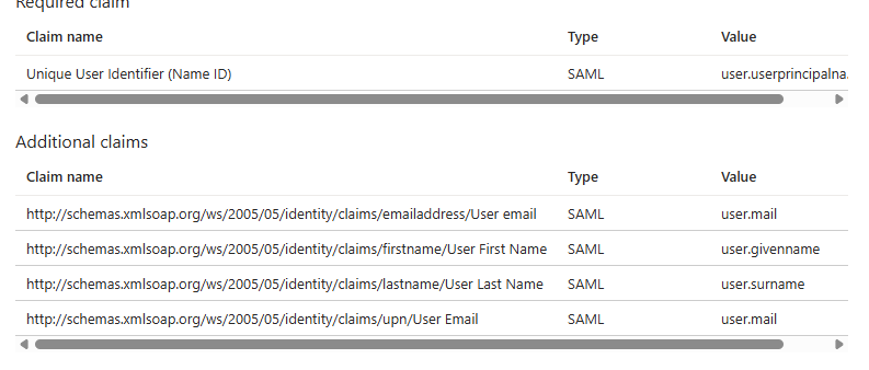

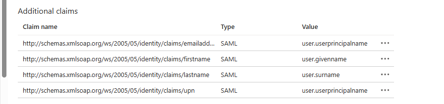

We are using Entra as our identity provider and would like to set up SSO via SAML. I have set up the attributes according to the documentation, but they are not being recognised when I test the SAML connection

Can you update your Claim Names to use the ones we document? It looks like you have included the value at the end of the name which isn’t needed so they should just be…

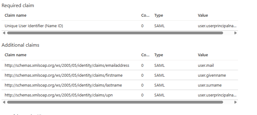

I have updated the claims, but emailaddress is somehow still flagging an error:
{“code”:401,“message”:“SAML Authentication failed: SAML Authentication failed. Invalid SAML response (missing attributes: http://schemas.xmlsoap.org/ws/2005/05/identity/claims/emailaddress).”}
@Leigh_Gallagher do you know if it is actually sending the correct value for user.mail or any value? Don’t forget we also suggest to map claim/upn to the user email as well rather than then user principal name.
I managed to fix it, it seems that user.mail was not being picked up properly. Fixed with the following attributes:
