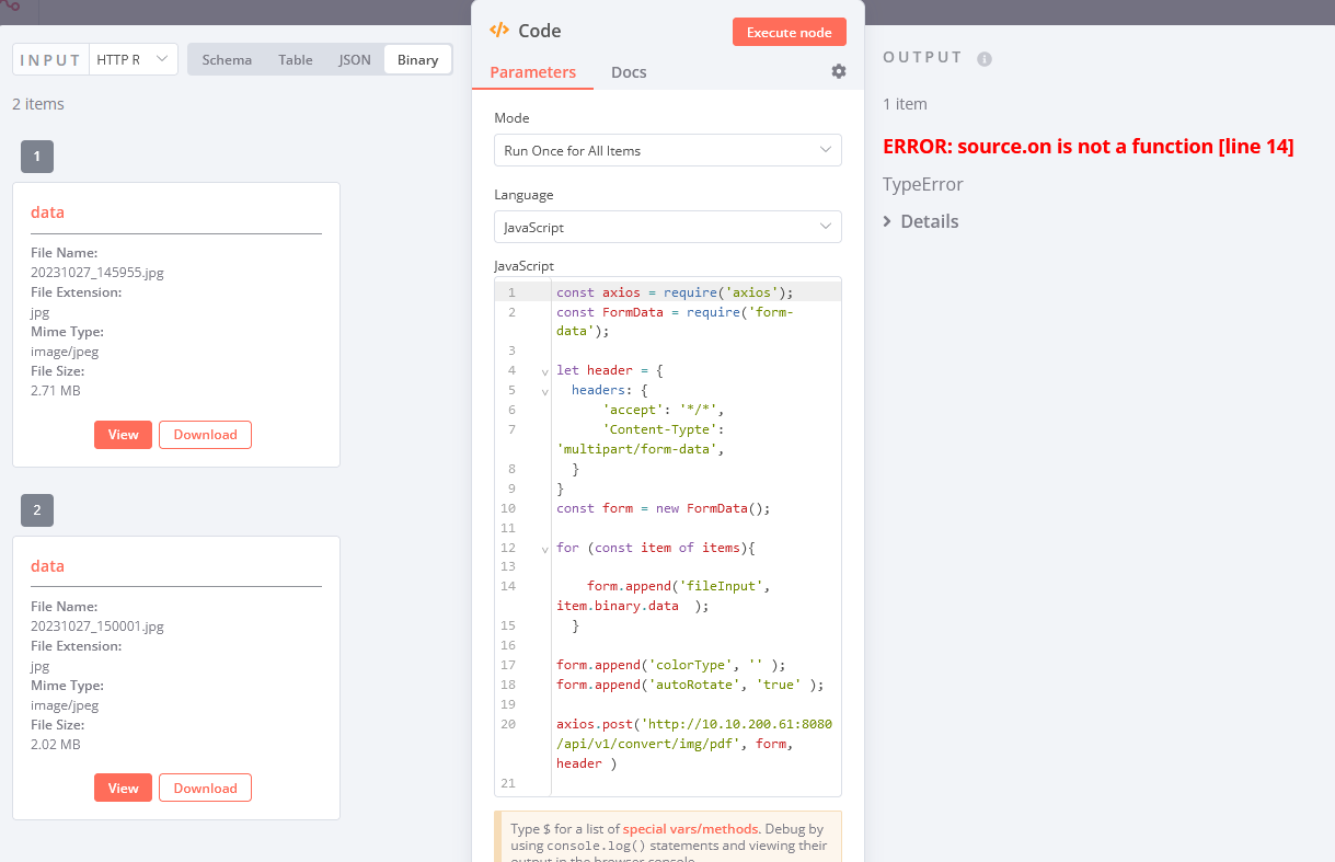

I’m trying to send all files from the previous node to an API , I should receive a single pdf in return.
I’m stuck at screenshot below.
Hi @mellesc, to make http requests in the code node you would want to use the respective helper function provided by n8n, as n8n might switch away from axios at some point.

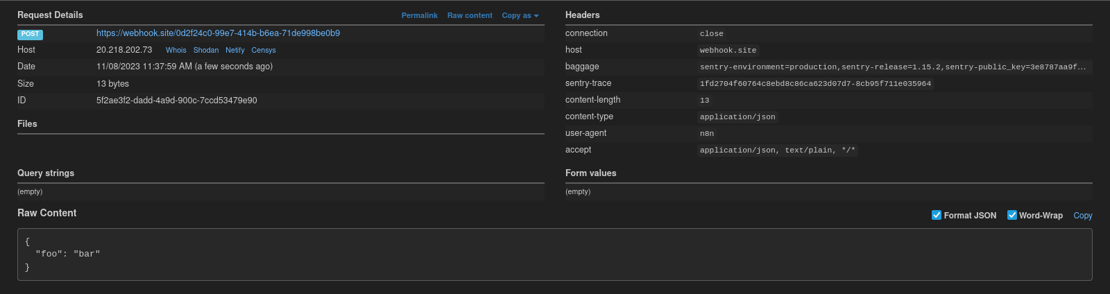

Here’s a quick example sending a post request:
This is the request arriving on the receiving server:
Hope this helps!
