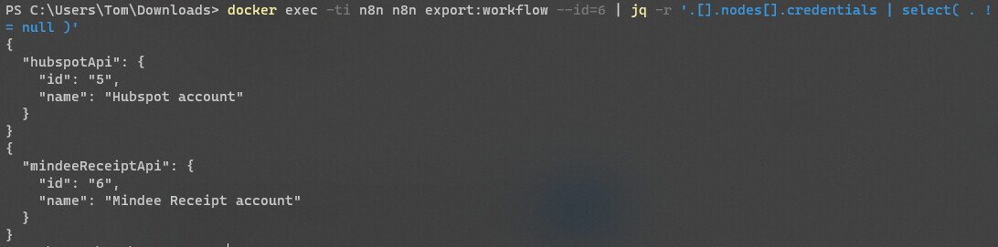

You are most welcome! If you need to do this regularly and through a script of any kind, you could try automating the process of extracting the IDs of credentials using a tool like jq.
For example, on I could extract the IDs of the credentials used in my workflow with ID 6 using a command like this (where n8n is the name of both my container and the command, hence the duplicate):
docker exec -ti n8n n8n export:workflow --id=6 | jq -r '.[].nodes[].credentials | select( . != null ) | first(.[]).id'
This would return just the IDs:
You could also output the entire credential object by removing the part after the last pipe:
