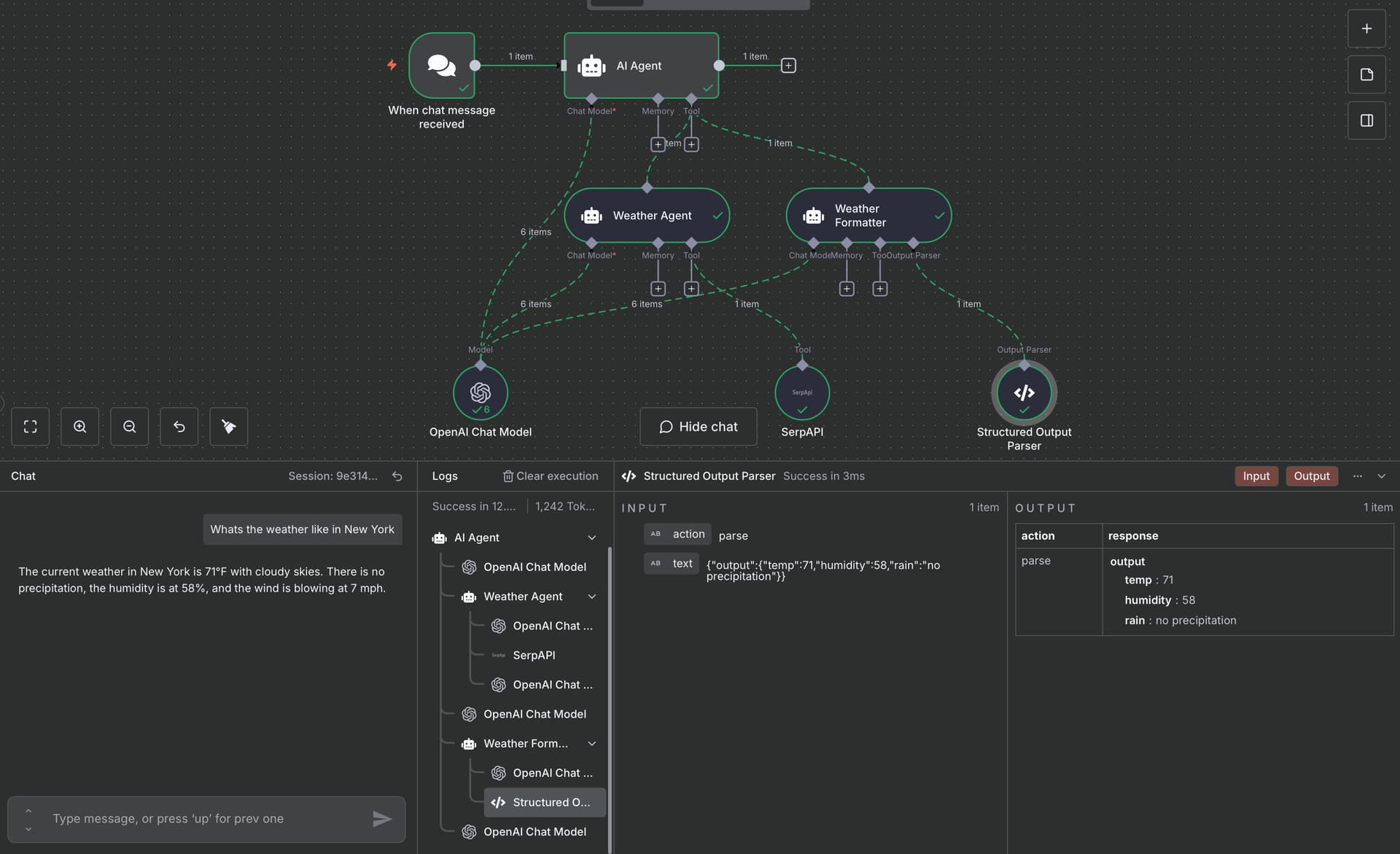

I want to connect an AI-Agent Node as a Tool to another AI Agent, but I am not sure how to get this to work as I can’t the main agent to actually ask the sub-agent anything. The main problem I think is because there is no documentation about the “AI Agent Tool” , and have the following questions.
  1. So does the sub-agent’s description get used as the tool description? How to get this to work?
  2. Once #1 is true, what to put for prompt input for sub-agent?
  3. Anything else I need to do to get this to work?
Here’s an example for you. Connect it to openai and serp api and ask the main agent for the weather. The key is to set a tools section in your main agent system prompt to tell it when to use what tool
Take note the agent for structured output doesnt really make a difference in this example, but it shows that you can get multiple sub agents to get called
So I got this working, and the key was the newish “AI Agent Tool” while still undocumented, works great. Basically you can put an Agent as the tool output for a main agent, and act as a MCP itself.
